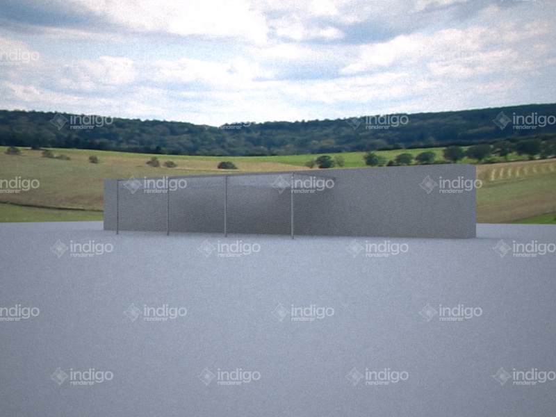

Hi,
why sun does not shine when I put it into the scene /attachment/. It is possible that the sun was shining and it I also used image in the background?

you have to check "extra Atmospheric" to get this setup work
Re: sun and backround
Zom-B wrote:you have to check "extra Atmospheric" to get this setup work
with "extra Atmospheric" does not work ....
It should work!
Doublecheck that your sun is actually in "day time",
also change away from Reinhard to linear or camera tonemapping.
fastest way is simply to upload your scene here and let me check it

Maybe your envmap/background is much too bright compared to the sun, try decreasing the envmap multiplier

You set your EnvMap Emitter to BlackBody.
BB is soooooo bright that brighter could not go ^^
Therefor your sun was "tonemapped down" and not visible anymore...
Try this settings for your EnvMap, Emission Scale turned off since it doesn't work for EnvMaps:

Yes, now work ! . Thank you very much.Zom-B wrote:You set your EnvMap Emitter to BlackBody.

Cool! Did you do the lawn using shadow catcher?
Hi,Oscar J wrote:Cool! Did you do the lawn using shadow catcher?
grass is just a texture and little polygonal grass .
