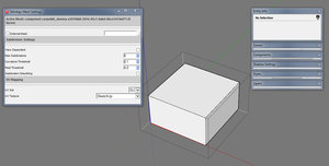

Just saw a thing: when I select a mesh to edit his properties a code is displayed nearby the real SU name. Is that supposed to work like that?

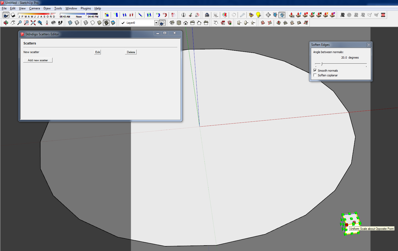

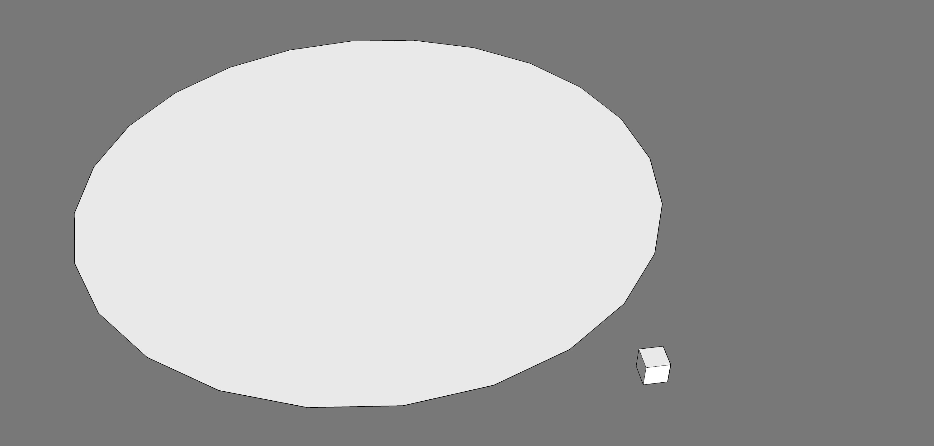

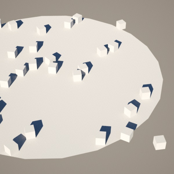

Ok here it is. Start with the first image, featuring the small cube (scattered object) and the circular base, both are components (NOT group since the "group name" SU property cannot be displayed by Indigo, can we fix that?).
The result of the rendering is correctly this one

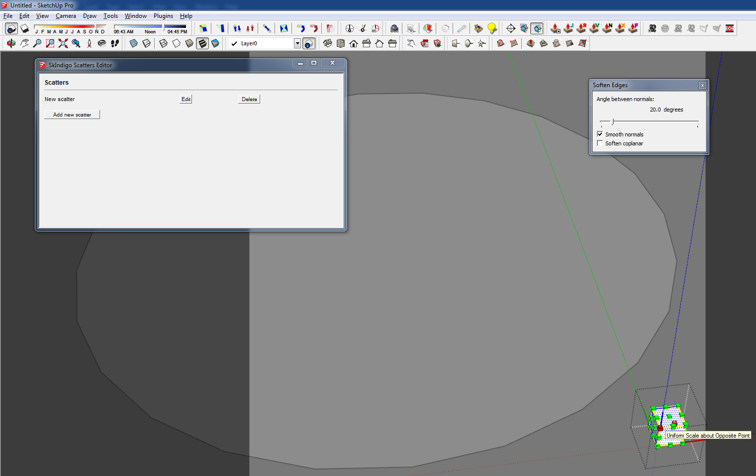

Then I tried scaling the component, say because I want to manually adjust the scale of the scattered object. First thing i do is select the component and try the scale modifier
The following image shows the result
But if I render I get the same image as before. No geometry modifications.

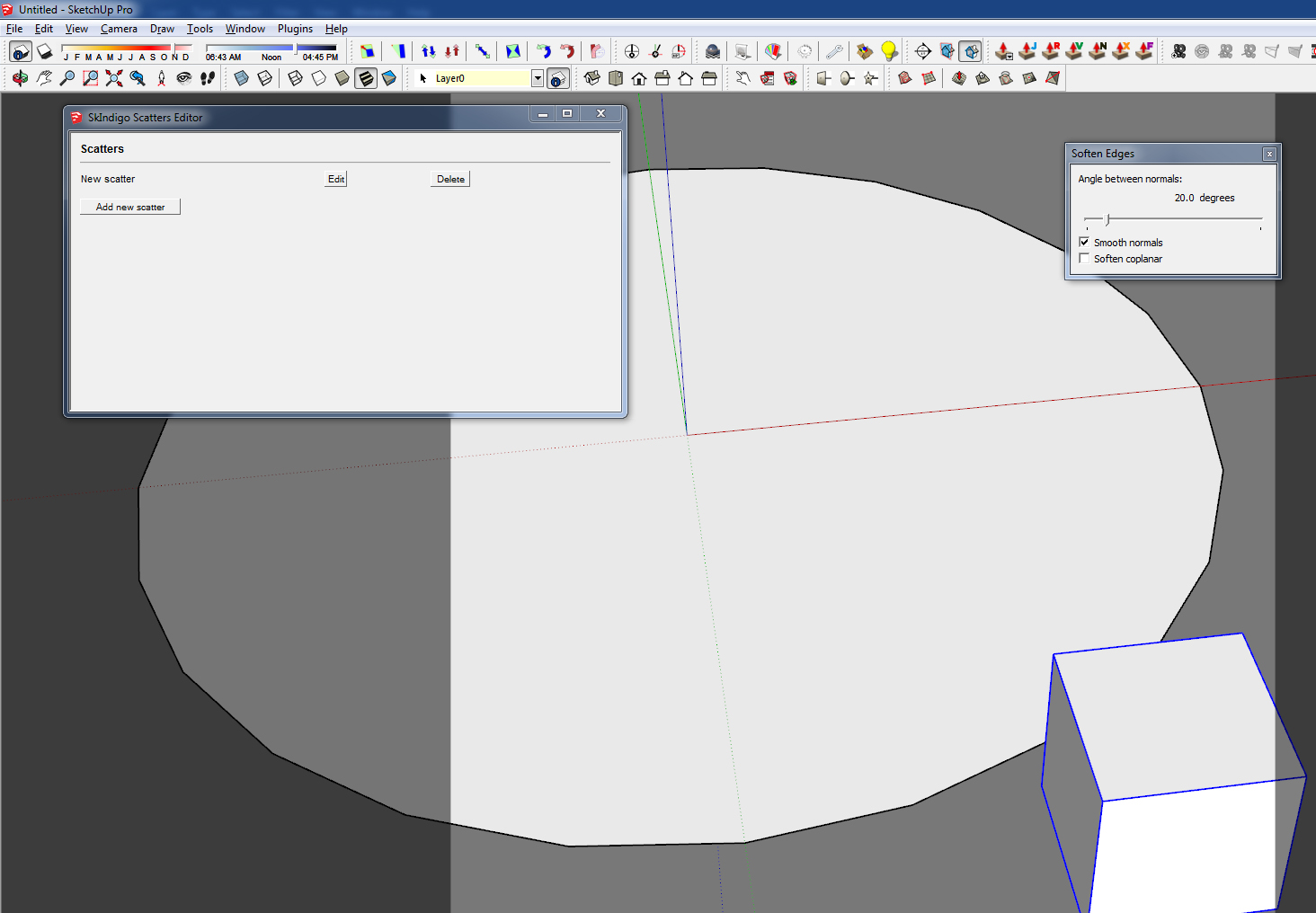

To get the correct scale I have to double click on the cube, ENTER the component (as seen in the following image)
select all and then scale the geometry INSIDE the component

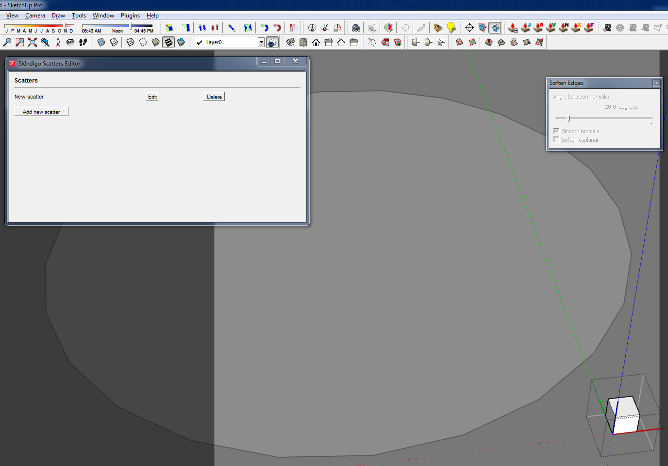

Then I get the scaled cubes rendered.
Hope I was clear.

Pibuz wrote: Just saw a thing: when I select a mesh to edit his properties a code is displayed nearby the real SU name. Is that supposed to work like that?
Have removed that 'code' now.

Pibuz: This build should fix your problems:
Some information is now taken from the first instance of given component definition used as a scattering object - the non-translation part of the transformation, and the instance material.
Also added evenness setting for scattering.

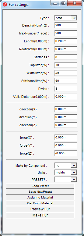

I attached the Fur plugin input box just for reference... The top drop-down field is a choice between "box" "leaf" "arch" "linear" and "rectangular".
Saving the preset settings is a useful feature...once I have my grass "just right" I'd like to apply it to a bunch of different sketchup models without going through the process again (could I also store my grass geometry to a default folder referenced within the Scatter menu?)

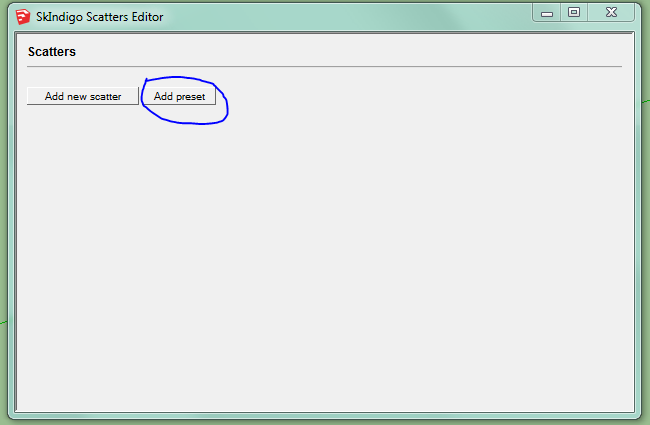

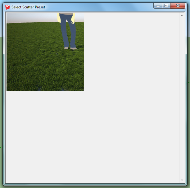

Post by OnoSendai » Thu Aug 14, 2014 12:21 am
Updated builds with initial, experimental support for scattering presets.
Currently it's just my grass preset.
Additional, better presets will be added in due course :)
