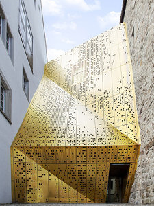

@bubs thanks for the tip, but the dummies strategy wouldn't be practical on models with complex envelopes where openings/boundaries don't follow horizontal vertical modulated patterns

This material should be done with instancing a elementary geometry tile instead of displacement! It's a little bit more complex to set it up in the modeler, but will be much more clean and efficient.

hi galinette, and how would you do that in sketchup with such a building?

Post by galinette » Mon Jul 14, 2014 12:27 am
I would do as explained, by instancing a base tile of the material, and define holes / cuts with a B&W textures blending the metal with null (this requires a shader, so I must admit that it's not easy to do)
I'm curious, is the whole facade made of stretched metal grid, with round holes in it? Can you cut holes in a stretched metal grid?

Post by sunlooksgreen » Mon Jul 14, 2014 4:14 am
no.. it was just to illustrate a case with a complex envelope; i meant.. just imagine you have to do such façade, with expanded metal and some big openings (no mix of holes+expanded..sorry to create confusion)
