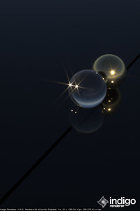

Hi. Well, out of convention scene ...
Things work quasi perfect (at min. 10 it's close, but 2 h is not enough for a perfect effect.
Working around this (for "exteriors" (outdoors).
...Discovering some cirscumstances about the filters now... The pigs more over inspected.
Suggestions are wellcome.

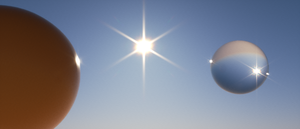

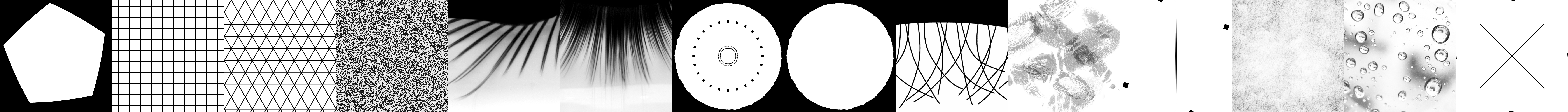

the simplest setup is the camera facing a skyless sun.
if I'm correct, using the same map for diffraction and as obstacle should result into the same than using the diffraction map alone.
While the diffraction map is more often of high density details (patterns even), the obstacle map shows easier with large patches. My clasic is a distorted disc, as to alterate the round bokeh's.

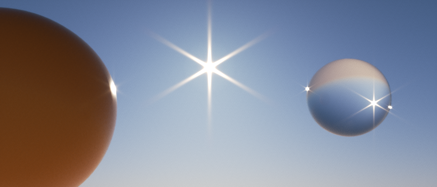

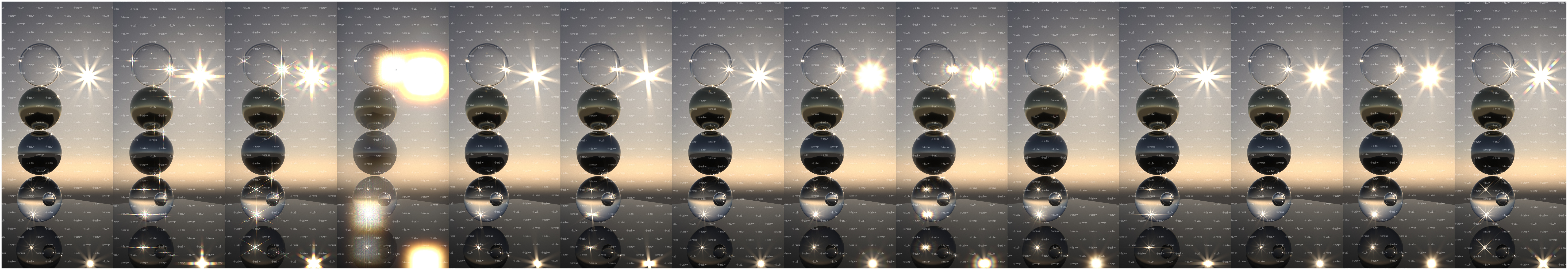

Hi again.
Usually the generated aperture is used, and now the obstacle map is a great element to complete nice effects.
300 s/p (200 seconds). For 3.8.
Is only a simple but very reach example. Every material, every sun position, every maps or parameters...
In order to investigate it is required to manipulate the XML ...
A specular material works faster for the base. Water without cauchy.
Update. The trick is simple: a igi solution serves as evaluate all the obstacle maps required.
Actually is necessary to resume the igi, then pause (or not) and activate aperture. Then save it.
This lines are required in the camera section:
Don't know what happens when aperture is defined as map (feeling that is unchangeable).
<obstacle_map>
<path>glare_obstacle_cf_1.png</path> -> direct the map here
</obstacle_map>Thanks in advance.
P:D. a cross writing....

Nice one!
Just tested your scene and looks pretty fast. Will try to reproduce something similar in sketchup, as I have no experience on editing xml files and start some tests..
Pibuz, I think yonosoy's scene or something similar is good enough to test those maps . I also think that sun should be part of the scene. Reflective objects + diffuse walls = time, so what do you think?
The autosaved image doesn't show AD for me too, did you solve it? Don't know what plugin you're refering to, something that puts square flat emitters over teapots? sounds good but what's that?

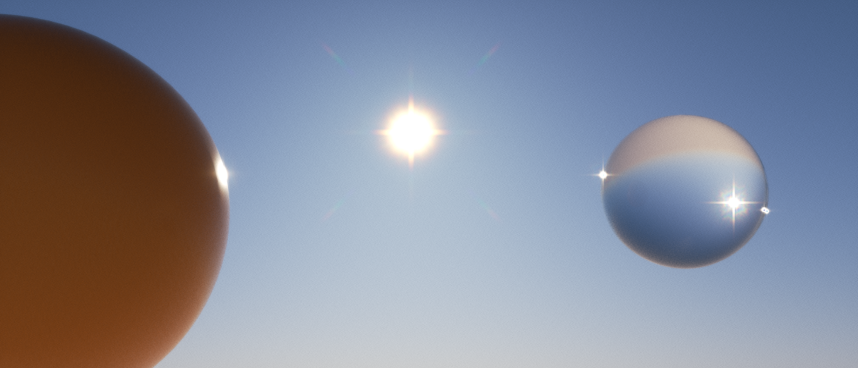

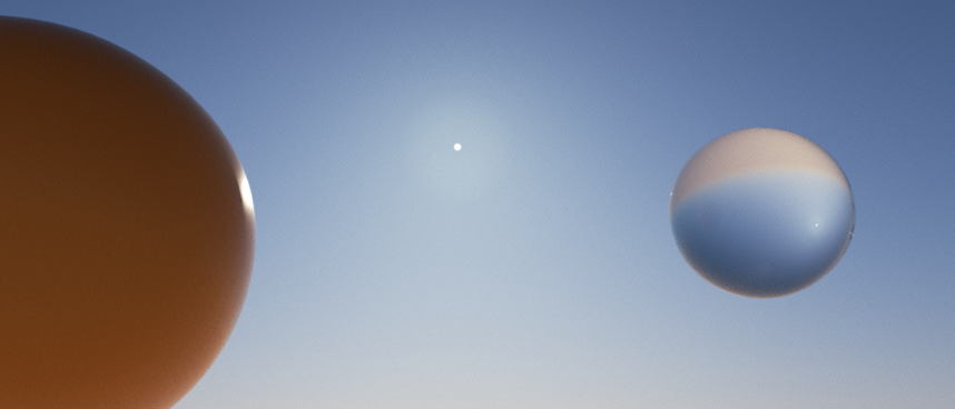

All right, here's my simple scene. If you render it more time fireflies might appear. I also updated the maps list for further tests. Also tonemapping is on camera so depending on the maps you will have to adjust the ev. Left sphere is default phong and the other is specular transparent. Check the image commets for explanation.

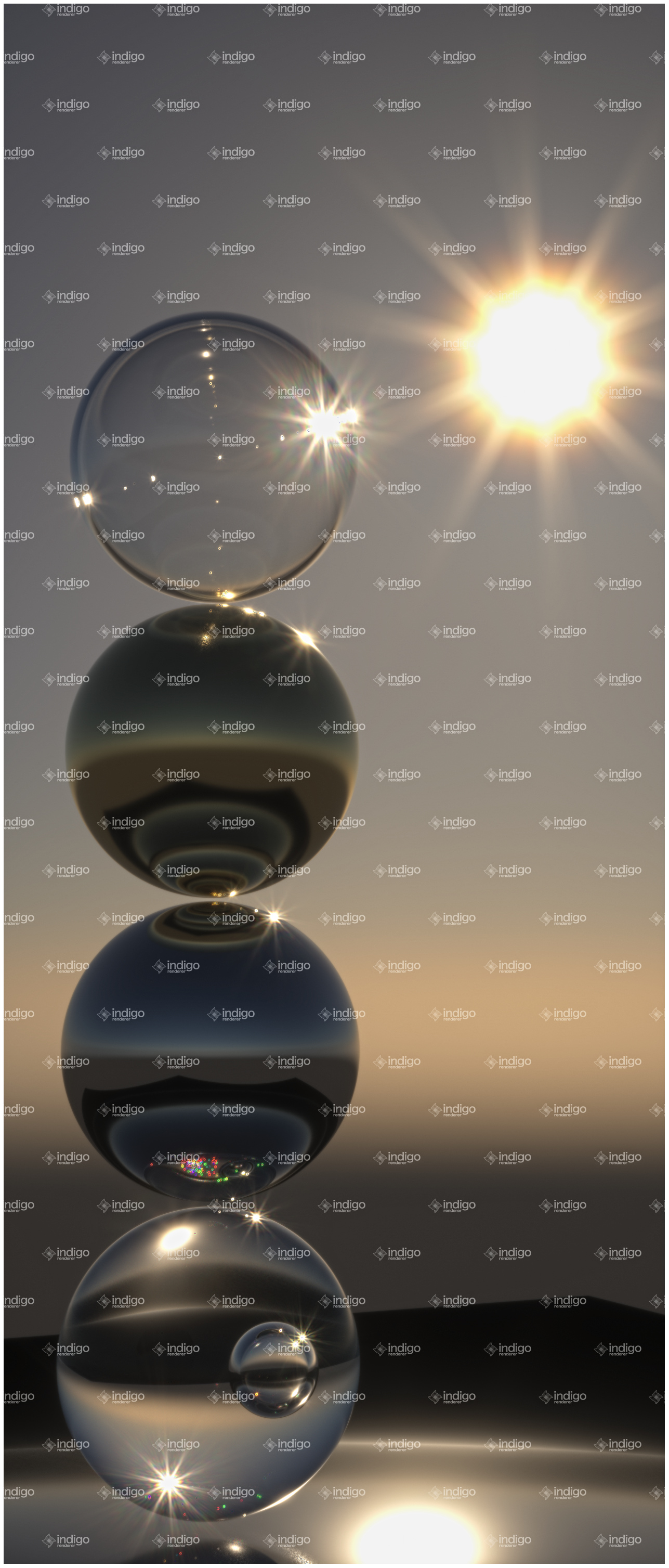

Hi. Learning some optics rules. 90 seconds test. Films dimensions.
List of approximate equivalencies (a multiply table).
Constant params:
Exposure, field of view, focal distances and tonemapping.
Variables params:
Sensor dimension, focal length and F stop (take in account that the cam is rotated).
1.33:1 (mm) --- 2.067 (mm) --- 1.33
8:5.33 (mm) --- 11.0 (mm) --- 8.0
16:10.66 (mm) --- 22.0 (mm) --- 16.0
24:16 (mm) --- 33.0 (mm) --- 24.0
36:24 (mm) --- 49.5 (mm) --- 36.0
72:48 (mm) --- 99.0 (mm) --- 72.0
Nature is exact ...
(don't know why the images are too much compressed ...)
