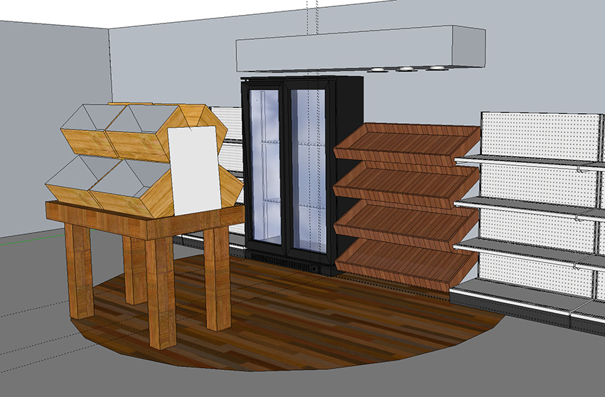

I have made this file http://energiilivet.dk/rhv.jpg in SketchUp, and start Render Scene friday midday, and stop it monday morning (3 days) when it says netx image will be update at 62 hours!
Im not impresset over the quality.
I think im doing something wrong, and maybe you can help me whit some setting (i have only touch the Image dimension to 1280x720)
I have a brand new iMac 7i whit 24GB ram.
I cant attach the SketchUp file.
Greetings Jesper

I attach a SketchUp pic and i think its a very simpel rendering draw!?

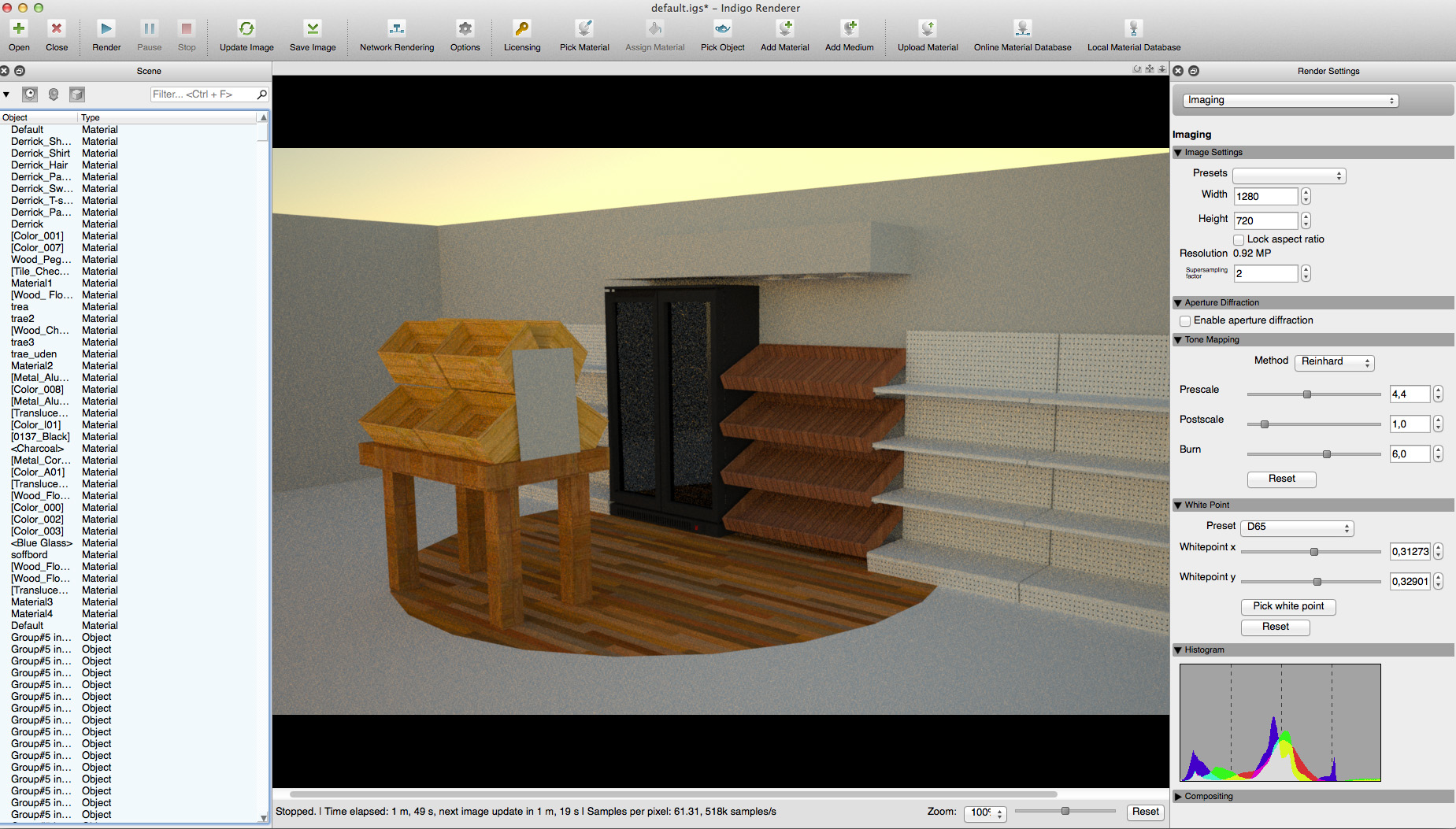

Post by Oscar J » Thu Feb 13, 2014 12:44 am
Give us more info. What rendering method are you using? Are you using glass acc/arch glass? What does your lighting setup look like?

@ Oscar J - the rendering method is Reinhard, if you mean in the Tone Mapping. I have not touch the materials, so it shoud be default.

Post by Oscar J » Thu Feb 13, 2014 1:39 am
Change the Imaging tab to Render settings - there you can find all the different rendering methods.
I think your scene looks okay now for being a two minute render.

No i dont mean realistic, i mean that the quality of the picture is mush like a lowres and i think it could be much better for a 3-4 hours rendering.
Se the picture here:
Greetings Jesper

Post by Patrice » Thu Feb 13, 2014 8:55 pm
I think your model is too open : try to put a roof and 1 or 2 walls for a more realistic light !
Here the light came from the top, right and left of your model so there is no realy good shadows.
