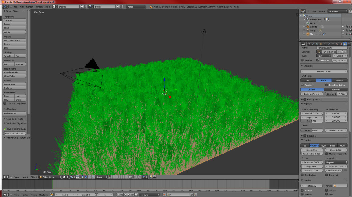

Hello,
I have a little problem with blender and Indigo. Let me explain my scene:
On an empty scene (just a camera and a light), I created an object of type "plane" to simulate the ground. I applies a brown material such as "diffuse" and I add another material green.
Keeping the selected object, I add a particle system with "Hair" type, I made ​​my adjustment to have a proper grass in Blender.
My problem is when rendering in Indigo, I see the ground, but not the grass, then with rendering blender everything is perfect.
Is there a way that the grass is rendered in Indigo ? If so, how ?
Thanks,
Scene in Blender
Rendering with particles

Yes. Don't use hair ;-)
Use a simple grass object modeled in blender and then use the particle system to instance it. StompinTom posted this little tutorial ages ago and I am not even sure if it still opens up in Blender that does exactly that.
http://www.indigorenderer.com/forum/vie ... =19&t=8846
The hair system in Blender is specifically tied to the strand renderer in Blender and I don't think, it can be used with any external render engine, be it Indigo, Luxrender, Yafaray etc.
Once you've successfully create the first grass you can use with maps to distribute it unevenly etc. works pretty cool actually.
