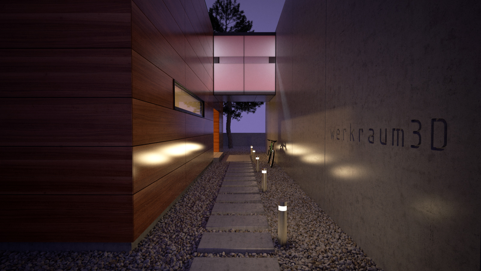

Here is my next try to set up the night scene. Can't get rid of the fireflies, though it rendered about 22h and has 8500spp, supersample set to 3. Render method Bidir Path Tracing.

Post by CTZn » Mon Feb 18, 2013 2:29 am
It's getting better.
Indigo offers several rendering modes, each with strengths and weak points. GPU Path tracing is for speed, but some scenes will use a more robust method.
This scene wants MLT. It will "spread" rays, including fireflies. Highly recommended.

Post by Pibuz » Mon Feb 18, 2013 9:47 am
CTZn wrote: This scene wants MLT. It will "spread" rays, including fireflies. Highly recommended.
+1

Post by lape » Mon Feb 18, 2013 11:03 am
you are so right! :mrgreen:
now with MLT and some changes for material

Post by OnoSendai » Mon Feb 18, 2013 11:06 am
Looking really good!

Post by LithiumDesign » Wed Feb 20, 2013 9:51 am
night scene looks great!! :D :D reflection bit too much on the wood? love the frosted glass on the top walkway and the texturing on the concrete - tried using a EXR environment? (EDIT: removed links --admin)
now i wanna know whats in the building on the left ;)
