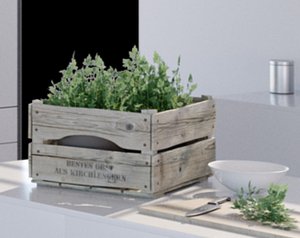

Here another Example of using the Foreground Alpha rendering in a real life scenario for background replacement, I scaled that example to 200%:
The base rendering:

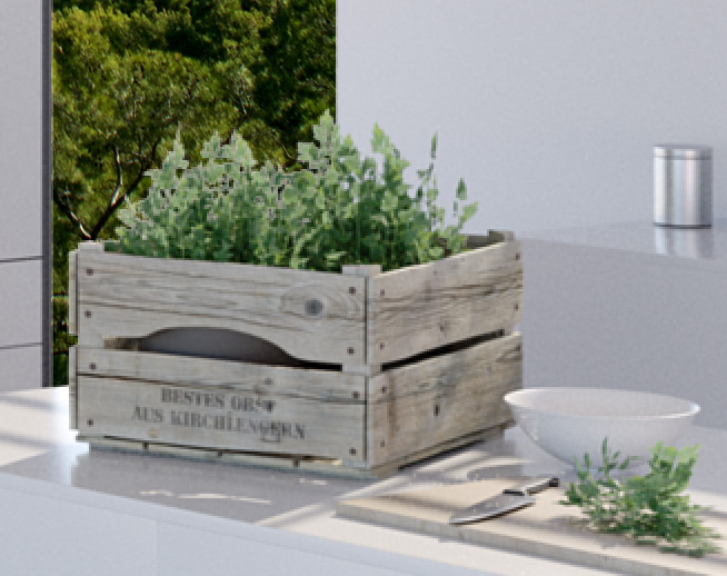

Applied alpha foreground mask:

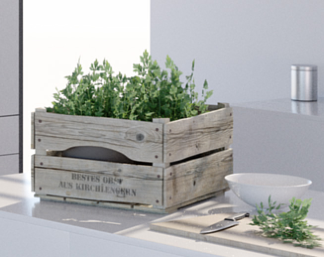

Example of background replacement:
You can see that white outline on the parsley :/
FakeShamus
Posts: 512
Re: Indigo Renderer 3.6.4 Beta Release
Post by FakeShamus » Wed Jan 16, 2013 1:17 am
Zom-B wrote:You can see that white outline on the parsley :/
In this case you are trying to replace a very brightly lit background with a much darker one, though. There is bound to be some strong back-lit parsley edges there with your light set-up.
Post by Zom-B » Wed Jan 16, 2013 2:10 am
I was referring to the 1pixel edge around the parsley and not the overall contrast / brightness.
A such "extreme" example was only made to show the problem clearly!
Since no DOF Blur or Aperture Diffraction was set here the withe pixel border is rather because of alpha masking in PostPro...
Also a BIG benefit for alpha background directly in the renderer would be the the possibility to keep reflections on windows in interiors. Atm I have a technique to get them by disabling Sky in the LightLayers, but it simply isn't that great...
