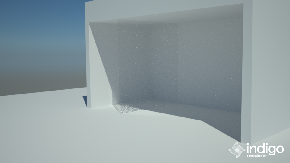

Post by wojtek-w » Thu Dec 20, 2012 9:55 am
hi,
i need some help with semi-transparent panels in my render.
Below is about 1k spp sample.
As You can see, the render is still loooong way to be clear.
Material is "frosted glass" from material database, panels are 6 mm thick. I did some test with glossy-transparent and specular materials too.
Architectural glass acceleration is on. Indigo is 2.6.1 version.
Is there any way to speed things up?
In this case render performance is much more important to me than physical accuracy so some cheating tricks are also welcome.
thanks.
