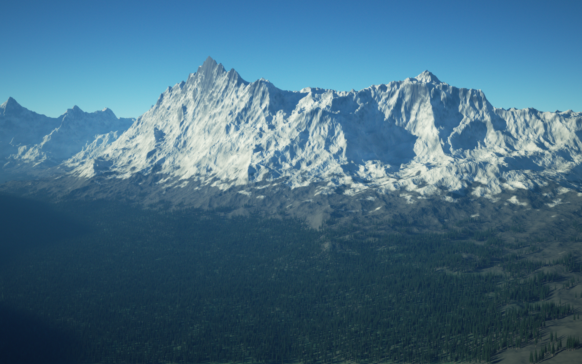

Post by fused » Tue Dec 18, 2012 10:38 pm
With trees and atmospheric scattering :)
Rendered over night.

Re: Scatter Tests
Post by StompinTom » Tue Dec 18, 2012 11:48 pm
Terragen much? :D
Looks awesome!
That's actually quite relevant for a project I'm working on ;)
By the way, how do you change a parameter based on altitude? For albedo, which does "eval(vec3 pos) vec3:", you can just multiply by "pos.z", but how do you set that up for bump / displace, which does "eval() real:"?
