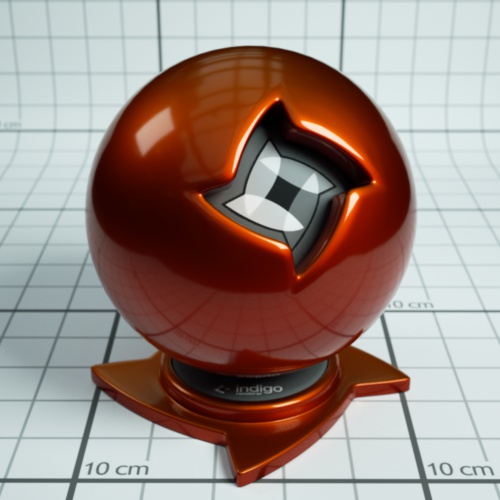

Post by CTZn » Wed Dec 05, 2012 2:00 pm
I did it myself ! Meh it's melting...
You can set the time it took for the coating to dry out in the shader for the Thickness parameter.
Or perhaps was it too much solvant...
Thickness: 0.0 <- 0.75 -> 2.5 mm
Drying Speed: 0.0 <- 0.52 -> 1.0
Melted_Coating.igm
(1.77 KiB) Downloaded 349 times

Uploaded Liquid_Coating.
Re: Coating material tests
Post by StompinTom » Thu Dec 06, 2012 1:43 am
CTZn wrote:Uploaded Liquid_Coating.
Beautiful!

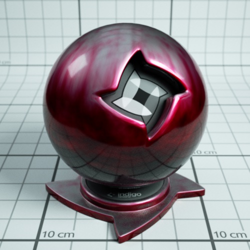

The next one can get real creepy sometimes... noise fun.
Jammy_Coating.igm
(2.52 KiB) Downloaded 323 times
Post by OnoSendai » Thu Dec 06, 2012 5:43 am
That's.. a bit gross :)
Post by CTZn » Thu Dec 06, 2012 6:08 am
I was frankly hesitant in uploading it... but it's just the previous material with a noise. Aw don't be scared that's strawberry :D
It's not optimum yet, I may even update the clean version. Anyone is welcome in polishing my empirical experiments.

Post by Pibuz » Thu Dec 06, 2012 9:39 pm
Those tests are really cool guys!
I'm very interested in the liquid coating material: con you CTZn explain a little how it works?
Post by CTZn » Fri Dec 07, 2012 2:27 am
Pibuz wrote:Those tests are really cool guys!
Hi Pibuz, it's pretty simple:
The slope is driving the thickness. A curve is applied to the slope, proportionally with the drying time/solvant quantity choosed and that's what is distributing the overall thickness. The noise also has a vertical scale modified by the slope.
Glad you like it guys. I'd never go by myself to a theater watch a scary movie I swear !
@Etienne: THANKS for criticism actually. You accidentally discovered that I'm happy to learn, so thanks a lot for the heads up. I'll get back to you with that.
