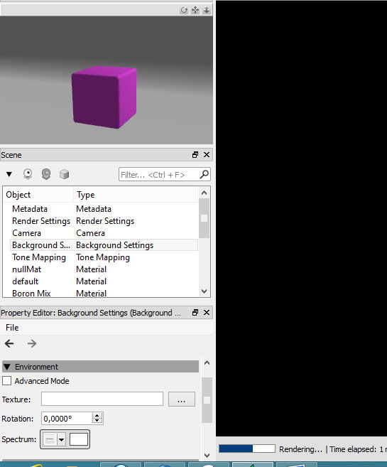

I was testing the new R14 with the latest Indigo Version because I want to change from Blender to C4D.
With Sun& Sky it works fine, but I can not get it to work with EXR map.
I´m not sure if it´s a problem of the R14 not working with the current exporter or a problem of my workflow.
I did the following:
Add a Sky object to my scene
create a Indigo material (Type diffuse)
assigned the exr file as emitter texture
assigned the material to the sky element
assigned the material as background material to the render preference in c4d
Start the "render in Indigo"
The environment settings in Indigo shows Environment map, but no texture is loaded.

Thank you for your hint. But the problem is the Texture is not exported to indigo as you can see on the screenshot.

Zlaty Lev wrote:Thank you for your hint. But the problem is the Texture is not exported to indigo as you can see on the screenshot.
Just an idea: It could be that the emission channel is not checked.
If it still doesn't work, could you send the scene, including the texture you are trying to use?

Post by Zlaty Lev » Wed Nov 21, 2012 7:34 am
Emission is checked, Files attatched!

Post by Zom-B » Wed Nov 21, 2012 9:37 am
Zlaty Lev wrote:Emission is checked, Files attatched!
Could it be a problem of the C4D Demo Version ?
I found the problem, you have set 3 different renderpresets, called Preview etc.
Well...
You edited "preview" but have "Meine Rendervoreinstellungen" active ^^

Post by Zlaty Lev » Wed Nov 21, 2012 7:28 pm
Well...
OMG :D
A real beginners mistake. Thank you for the help.
