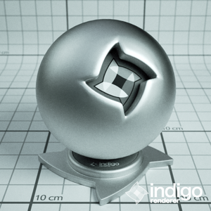

Does anyone have a material that is like the brushed aluminium Apple use on their products?
I've looked in the material database and there isn't one that is right. I tried to edit the Brushed Metal texture: http://www.indigorenderer.com/materials/materials/212
However it is too reflective and the colour/texture isn't quite right. I'm a bit of a novice at the though.

What you show on the picture is not really brushed aluminum but rather rough anodized aluminum.
Just start with a phong material, set the nk data to Al, and set the exponent to a very low value such as 1. That should be closer already.

The Apple devices usually don't exhibit a "rough anodized" finish. The surface is usually very finely glass bead blasted and then anodized, so the surface should definitely have an exponent larger than 1.
For a close up I'd use a subtle very fine grain bump with NK material and perhaps Exponent 100+

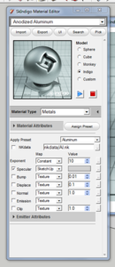

I once made such a material, if I remember right the setup was as following:
Material type: Metal
Specular: light grey color, about 35-40 percent of grey
Exponent: somewhere between 10 and 20 if I'm correct, could be slightly more, but definately not over the 100
I'll see if I can find the renders I made and the corresponding material when I get back home.

FoXar
Posts: 139
Re: Apple Brushed Aluminium?
Post by FoXar » Fri Nov 09, 2012 6:53 am
Nope I haven't, here's the setup ;)
