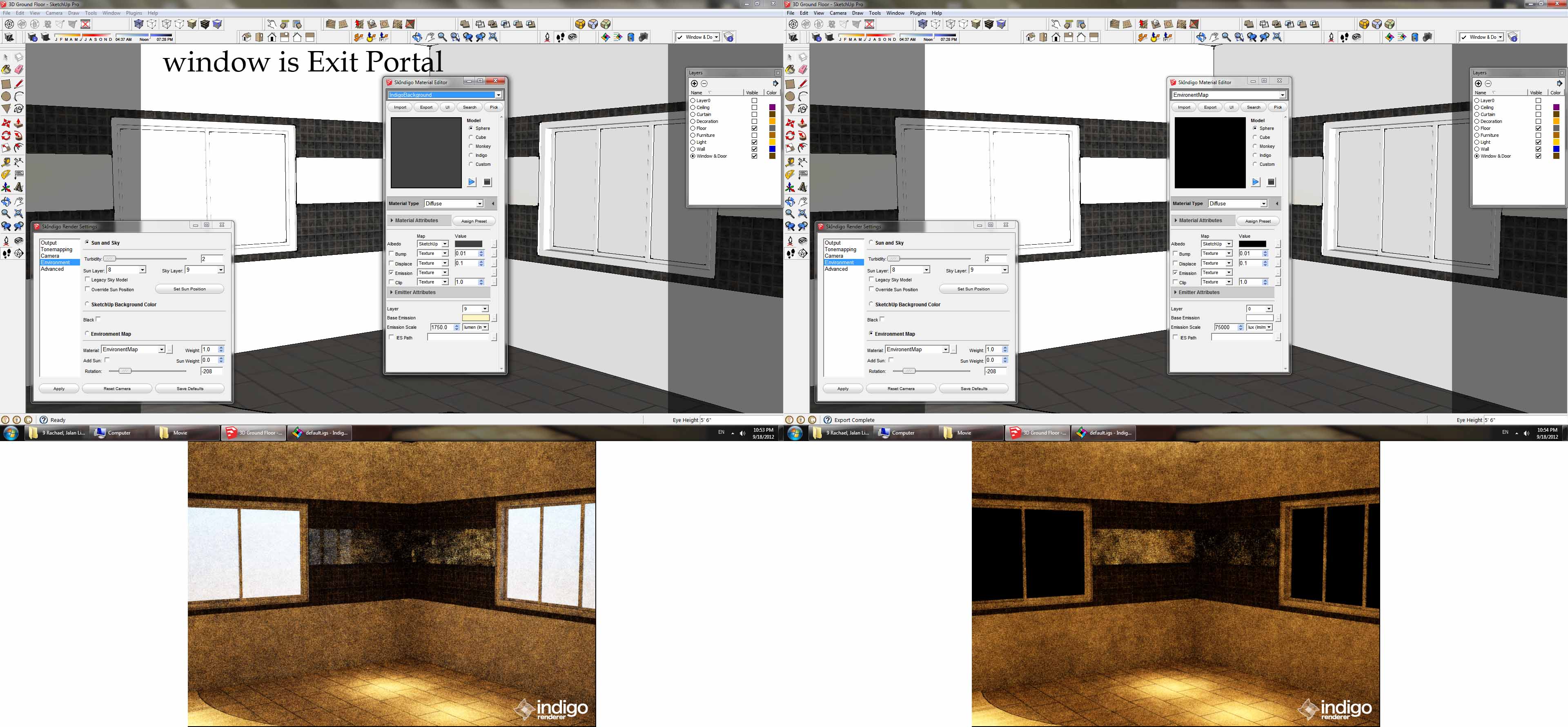

williamhhf
Posts: 37
Joined: Sat Apr 23, 2011 4:36 pm
Re: Environment Map can't set together with exit portal?
Post by williamhhf » Wed Sep 19, 2012 3:06 am
CTZn, here is the photo i try to show you, im not good to explain, can u help me to check is that any wrong from the setting?

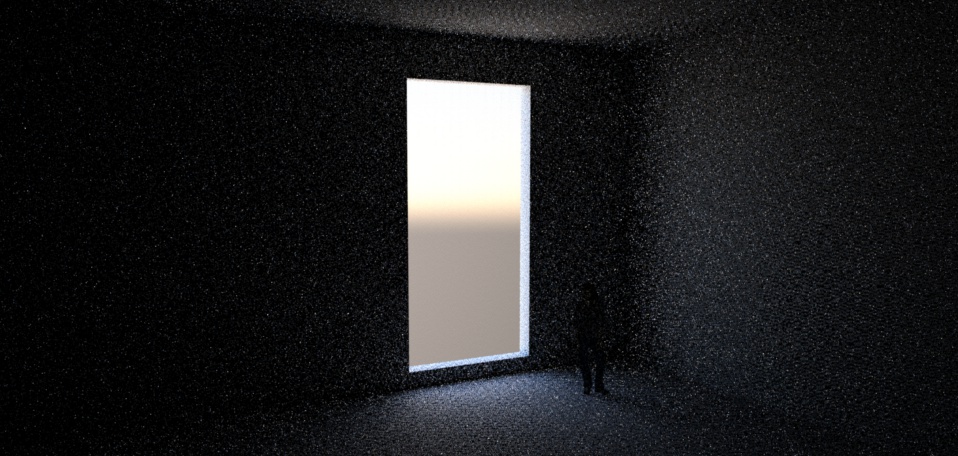

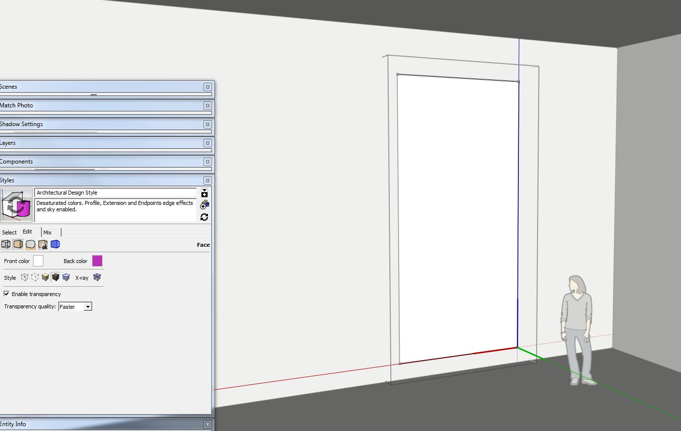

This looks to me like you have the faces in sketchup pointing the wrong way, ie the normals are reversed. The 'front' face of the exit portal should be pointing into the scene. Easy way to tell which way faces are pointing in sketchup is to go into 'styles' and change the face back colour to something really bright like a mad pink or something. That way its really obvious if you have faces pointing the wrong way. The default pale blue can be misleading.
I ran through some test scenes trying to recreate your problem - the only one that looks like yours is if the face forming the exit portal is facing the wrong way. If you have the environment set to SUN & SKY then light still enters through the portal, albeit in a slightly odd way. If you then set the environment to and Environment Map like you have done, notice it renders black. I had to add a light in to show the issue.
EXIT PORTAL, Sun & Sky, normals facing wrong way

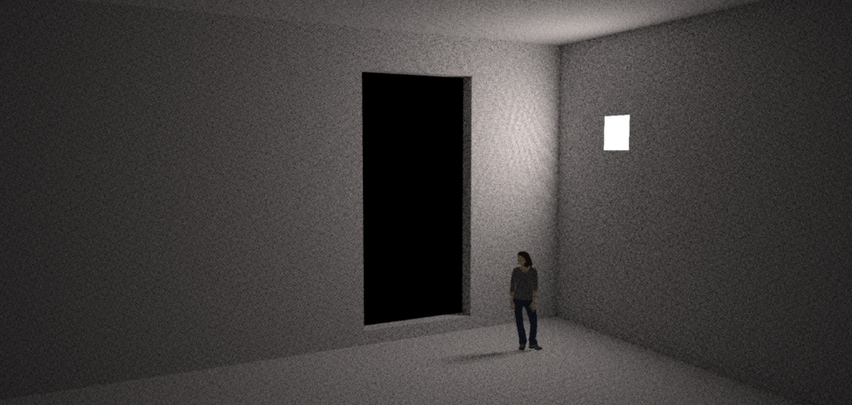

EXIT PORTAL, HDRI, normals facing wrong way

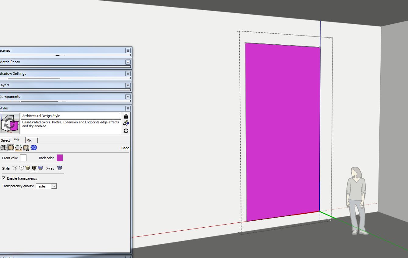

To make it clearer:
In styles I have made my back faces pink. If they're facing into the room on the exit portal this is BAD!
If all is white (or whatever colour your front faces are set to), then this is GOOD!

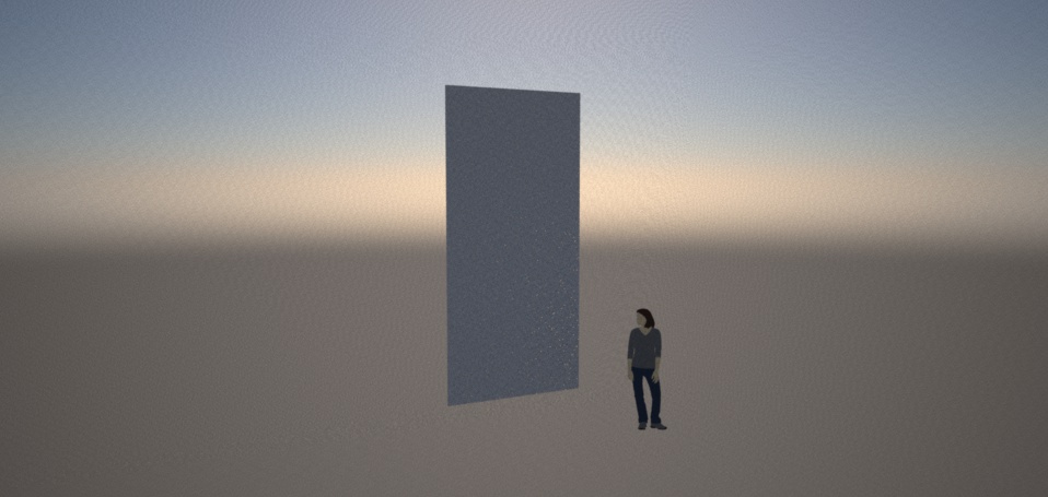

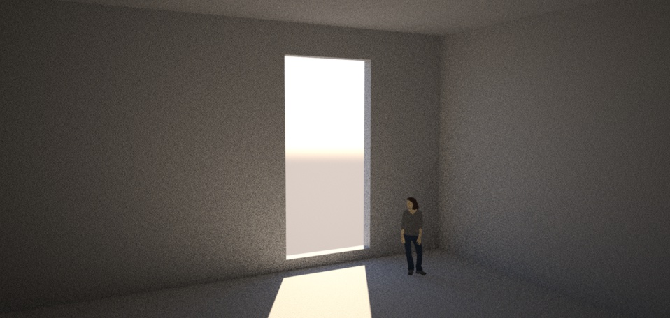

Just for interest here are some more which show the behaviour of exit portals in different conditions:

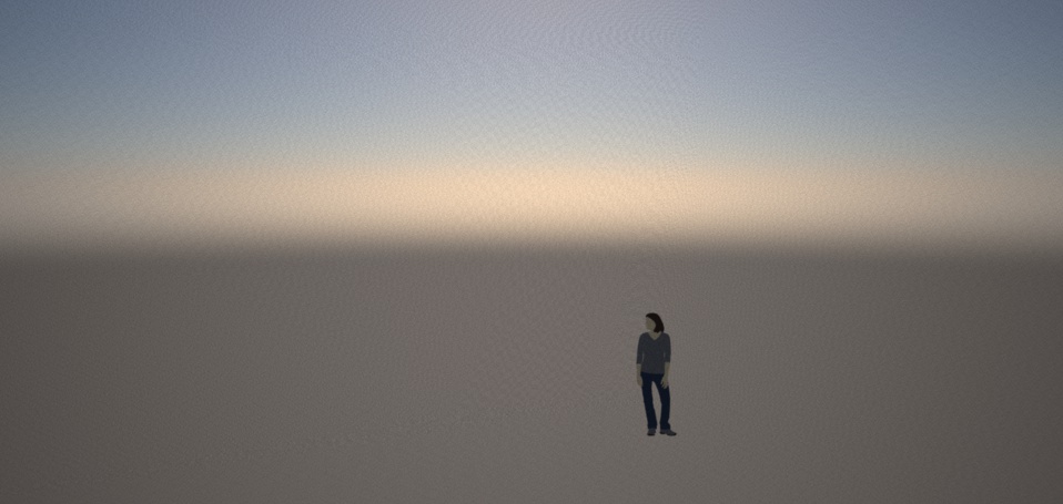

1) NO EXIT PORTAL

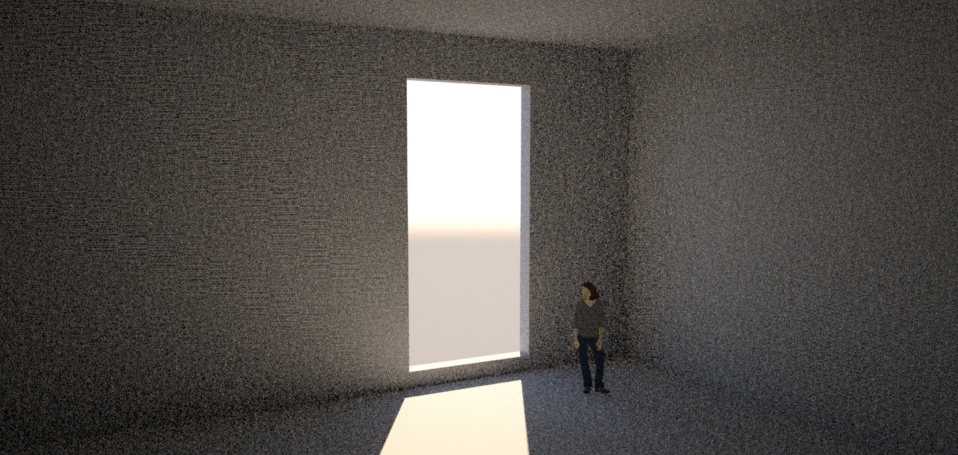

2) EXIT PORTAL ADDED

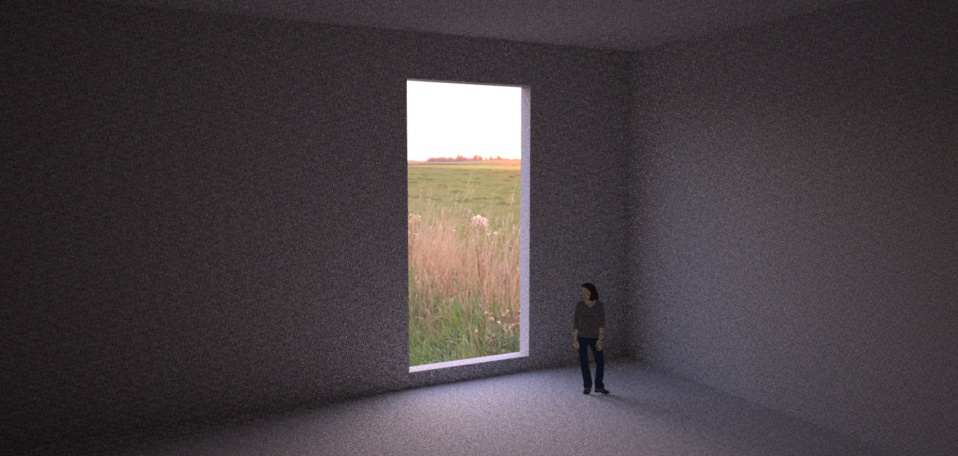

3) NO EXIT PORTAL - Sun & sky setting, note the lady stood outside is visible.

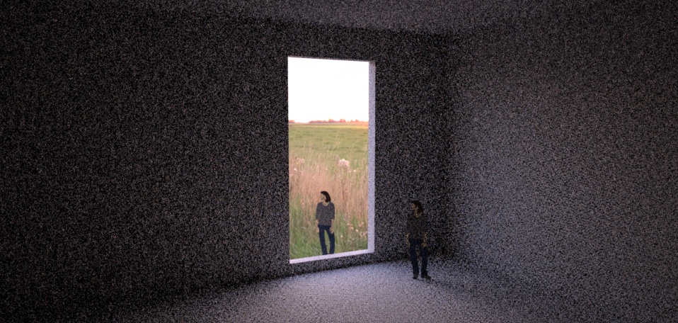

4) NO EXIT PORTAL - HDRi setting, note the lady stood outside is visible

6) EXIT PORTAL ADDED - HDRi, lady is not visible. The HDRi details are seen, but no geometry outside the exit portal.
