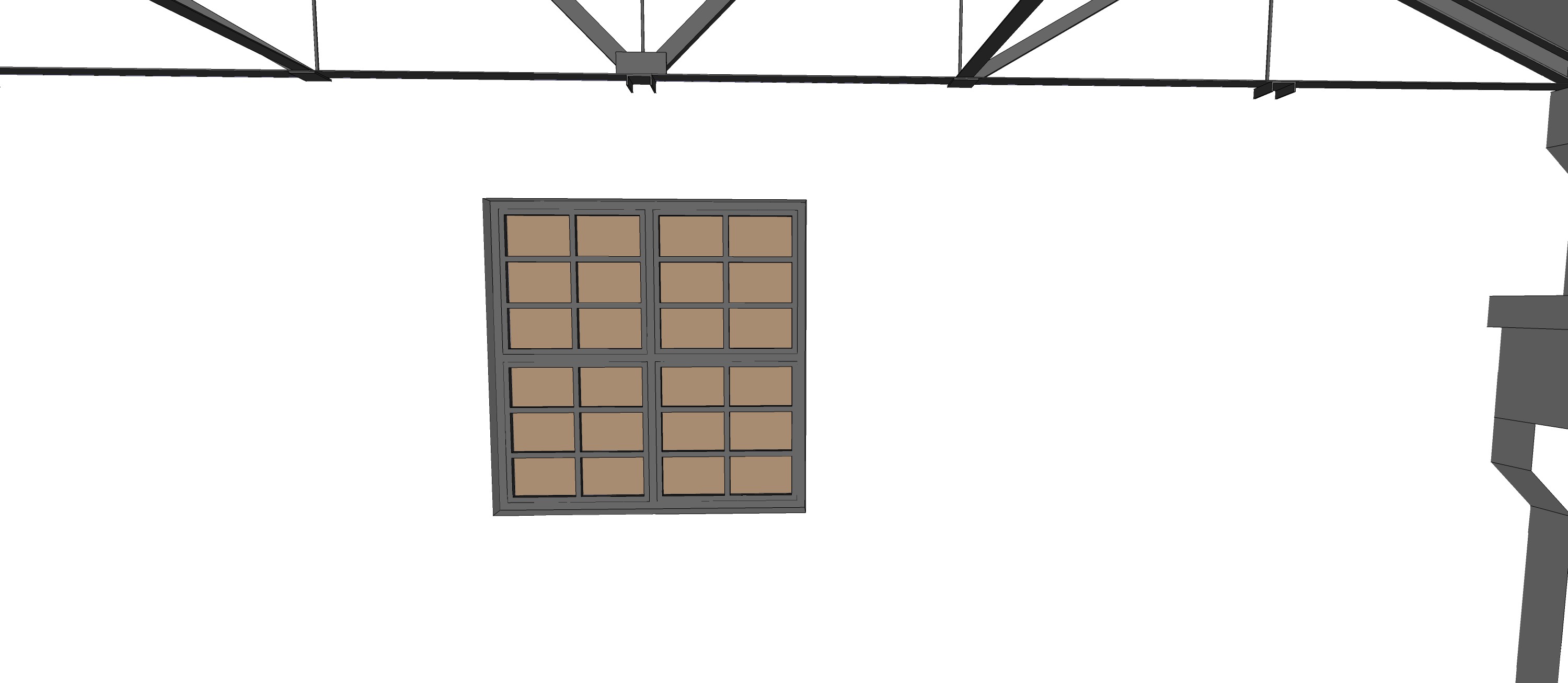

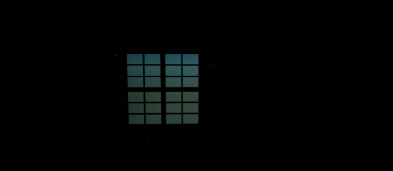

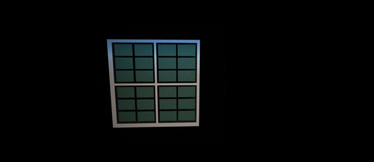

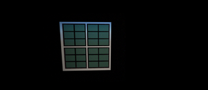

Just having this problem with my windows, below are two examples. One is the original window as a component with exit portal on the outside and the other exploded component window with exit portal on the outside. For some reason the component window has the outer frame missing while the one I exploded works fine (I believe). Does anyone know why this may be happening??
O within the component window the smaller frames are components too. I've attached an image out of sketchup too

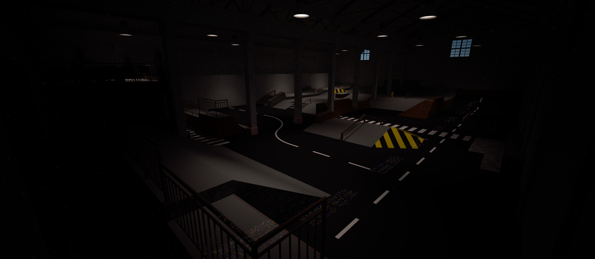

Yeah I noticed that some other windows that I had developed from this original window component were working fine (without the framing missing). In the end I rejiged these windows to have the exit portal protruding through the surfaces they were touching and made the glass double sided and protruding through surface as described in that manual on physically correct glass modelling. I then copied one of them, made unique and configured to suit the ones causing the problems and wala, no problems. Just jigging the materials now as I believe they are cauing some 'fire fly' problems as shown in the attached image. I also need to get the lights working a bit better ( maybe lowering in places, having more of them..?). Currently they are 1000w lights using IES file from http://www.lithonia.com/Photometrics.aspx?Fid=72612

there is a good chance that the glass material is you are using has some cauchy b value, or is quite complex.
For windows like these simply use a transparent specular material with ior of 1.52, done. Even better to simply remove any glass windows from the scene, since you can't see them anyway
Finally you should know that EPs and sun doesn't work together. the noisy part f the image is the sun area beeing calculated...
The black collor of the "street" of your scene seems to be fully black... therefor it doesn't reflect ANY light and will stay black... raise the RGB value a little!

Exit Portals and Sun work together quite well if you use BIDIR. Just don't use Pathracing as the render mode! That goes for GPU supported PT as well as for Non- GPU supported PT.Zom-B wrote:there is a good chance that the glass material is you are using has some cauchy b value, or is quite complex.
A good idea is to also study the materials from the Mat DB, so you get to know them and can create own materials in the future by understanding them!
I've stopped counting how often I have advised newcomers on the forum not to use PT for interior scenes that are being lit by direct Sunlight. I guess the big attraction Is the GPU support that in most render engines only supports Path Tracing. It just is not the best render mode for every scenario!
Try BIDIR for this scene and toss the glass. Unless you expect to see reflections in the glass it really does not add anything and just slows rendering down. If your do feel the need for glass then, for this interior scene use simple glass without tabulated absorption and Cauchy B and turn on glass acceleration.
