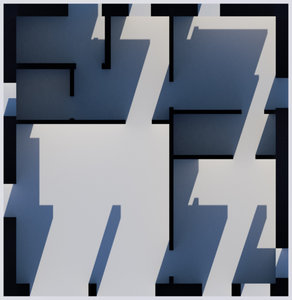

CTZn wrote:
About orthographic cameras:
a little example with SkIndigo (same house as
before):
