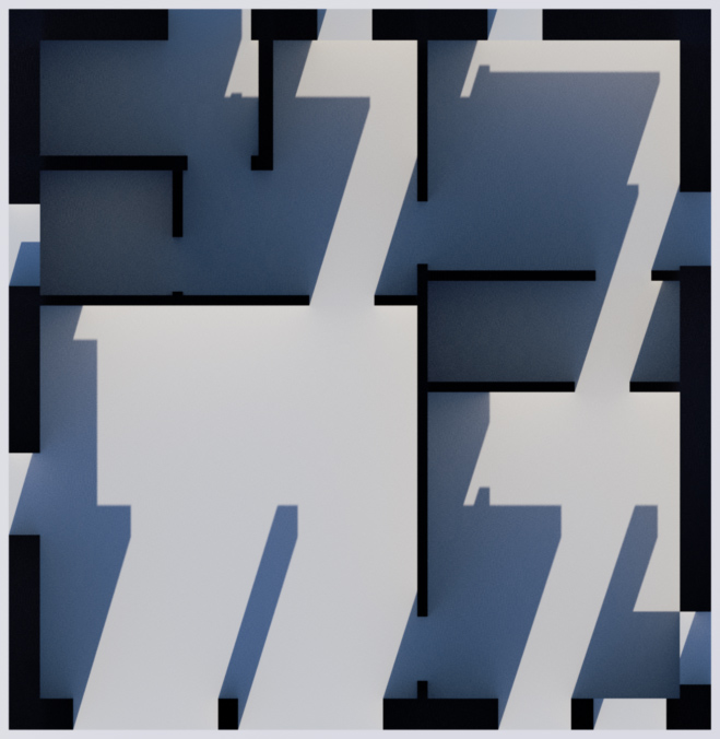

CTZn wrote: About orthographic cameras:
a little example with SkIndigo (same house as before):
