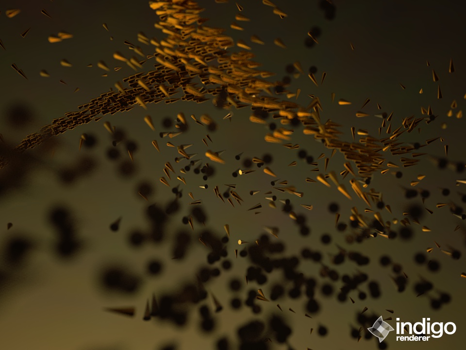

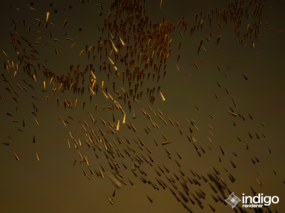

Added aim at velocity for particle instances, finished nurbs implementation. Consolidating code where this wasn't possible before MtI used Maya matrices (holy fix).
Re: MtI 3.2.5
Cool! Looks like those arrows need some motion blur though
Re: MtI 3.2.5
Yes, particle instances lack motion blur. The method MtI is using for keyed transforms is not relevant for dynamic particles, probaby the simulations would have to be baked first. I am reviewing the keyframe method, and more than that actually; I want to add robustness to the many "proof of concept".
I forgot to mention previously that unknown shaders are now converted to indigoShaders, defaulting to diffuse though. vRay scenes and other mr should render at once.
