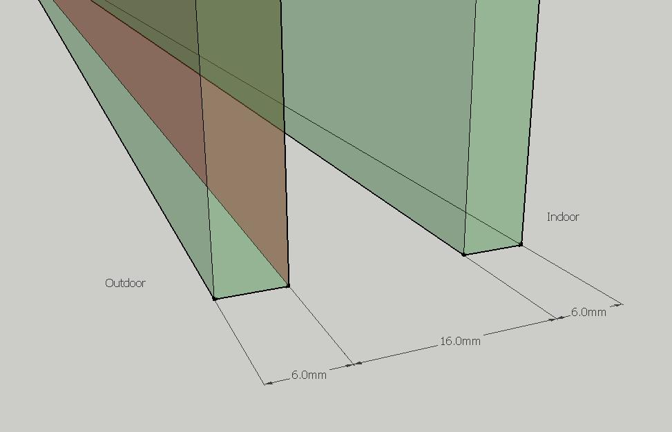

I'm too dumb for that description.
Could you please upload a simple drawing with arrows and selections and material names and such?
Thank you very very much in advance!

Re: Coated glass models - SGG/Glare development
Before you got what you asked for zeitmeister, I'll risk a reformulation:
Given a double pane window system with a gap between each pane, the coating must be applied onto the one face facing the other pane. The 5 other faces of each pane are expected to have the Planilux (uncoated) material applied.
Now, both materials (Saint-Gobain Glass Planilux and Saint-Gobain Glass Cool-Lite SKN 165) are sharing the same medium wich is fine (the coating is lying onto the surface of the material, the medium is therefore "independent" from the coating effect); however it will come defined twice in Indigo, once per material imported/linked. This is currently leading to unpredictable results and only the first declared instance of the medium called sgg-planilux should be present in the IGS file, requiring a manual operation after the export and before the render in most cases.
This last operation (or paragraph) should be not relevant anymore in future Indigo versions.
edit: this simplification from me is incorrect, see the posted image below in this page. Still unofficial, just for quickness sake. The ideal usage (section):
where:
[ ] : SGG Planilux
| : SGG Cool-Lite SKN 165
After export, the IGS content for the concerned materials will probably feature a double declaration of the same medium. The second declaration if present (depending on exporters) should be deleted by hand until the fix is delivered by Glare Tech.
Etienne, I sent you a PM around these lines already: is it worth/possible for exporters writers to implement a private_data tag for embedded SGG presets (media and materials being defined separately) ? It seems to me that the license does not allow for this currently... I am not even sure wether the topic can be discussed this publically.
where:
[ ] : SGG Planilux

A small drawing is always better than a long speech!zeitmeister wrote:I'm too dumb for that description.
Could you please upload a simple drawing with arrows and selections and material names and such?)
Green = SGG Planilux (raw glass) material
Red = SKN 165 (coated glass) material
Et voila, you have modelled a fully realistic modern insulating solar control glass. You may add the aluminum or painted spacer frame bonding the two glasses together for better close-up realism.
Don't forget to remove the redundant "medium" in the exported scene until glare has fixed the "medium declared twice" issue. Another solution is to include first SGG Planilux in your scene, and use a coated igm where you stripped off the medium tag. If your exporter exports materials in the same order than you added them, like sketchup does, it should do the trick.
Etienne
