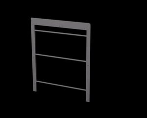

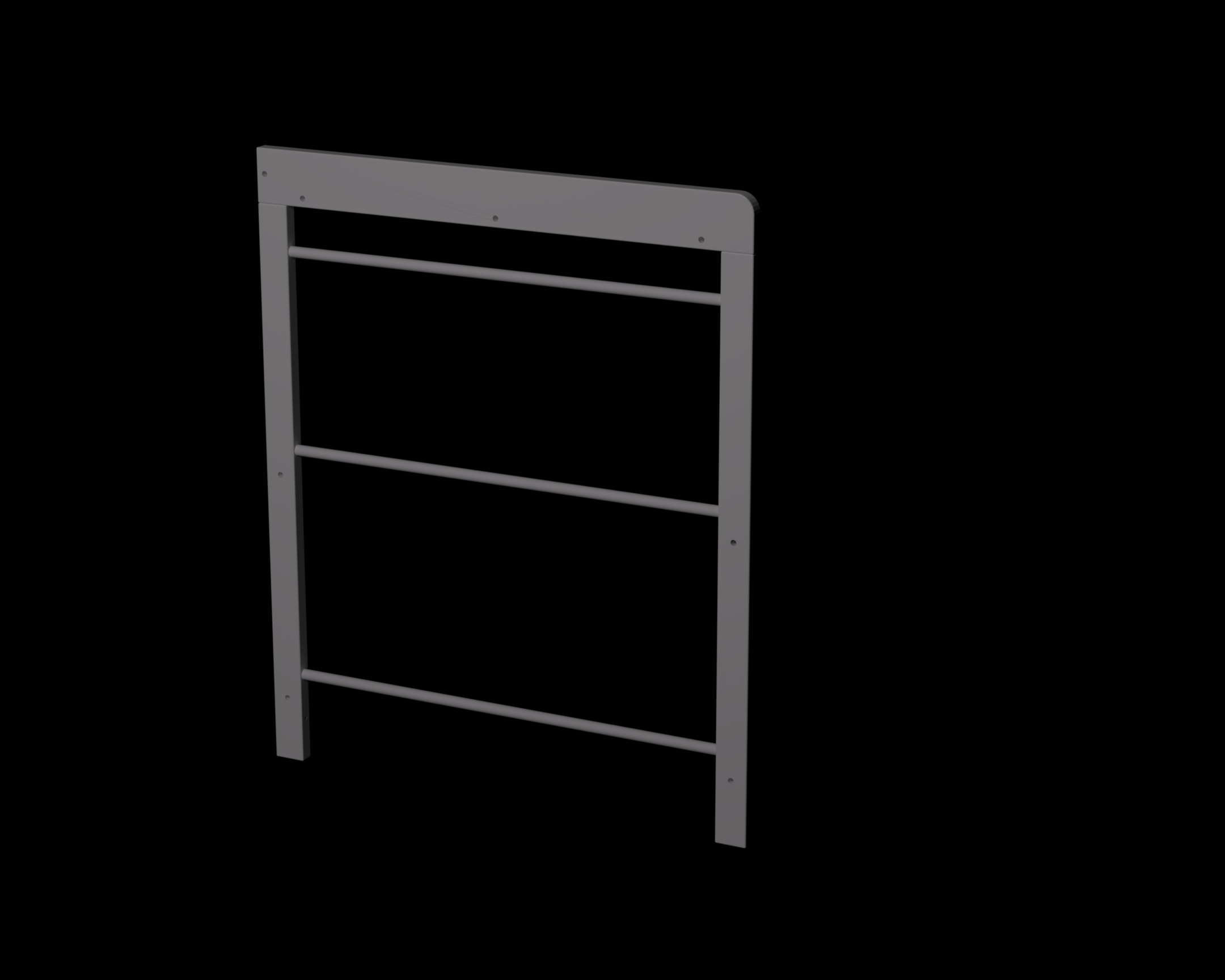

but still bug with large tri.
I don't use very last nvidia 295.20 but 190.10. Maybe you can try this .igs to see if it's linux issue
please have a look to it
thx
large tri.pigs
(157.79 KiB) Downloaded 371 times

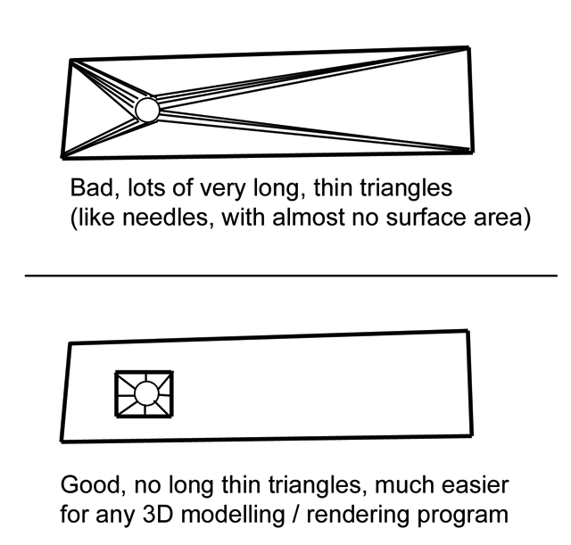

Post by lycium » Sat Feb 18, 2012 3:24 am
The source of the problem is that those triangles are so thin, they become 1-dimensional lines (which cannot really be intersected by any ray).
The correct way to handle those kinds of situations looks like this (sorry for the poor diagram):
Avoiding degenerate triangles

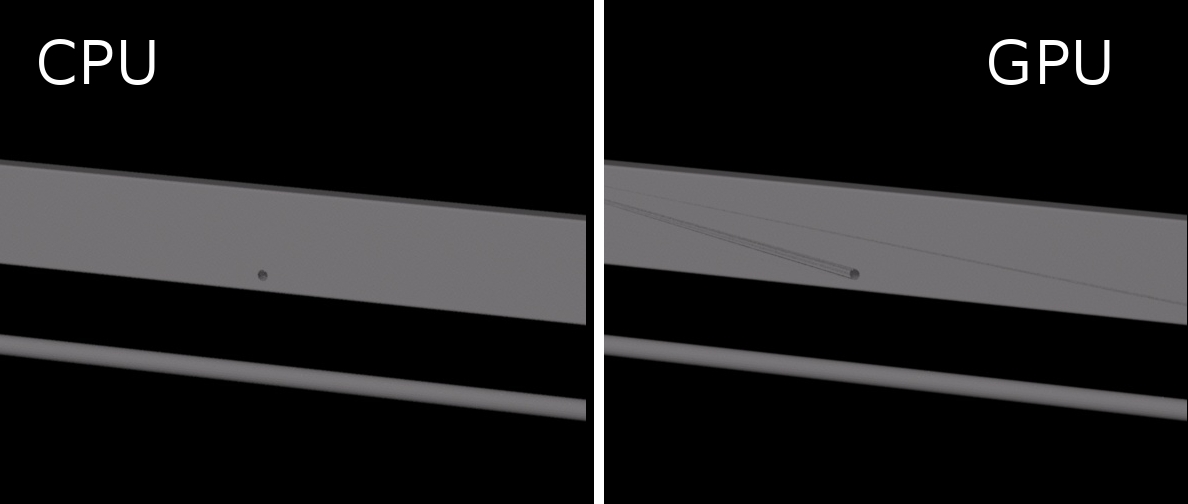

Re: Indigo Renderer 3.2.8
Post by Zom-B » Sat Feb 18, 2012 3:26 am
just tested with 295.51 on my windows machine and having some issues here too, but less noticeable then in your pictures.
I remember that Indigo had (speed) problems with very long "needle" polygones... the knife tool could be a quick workaround here for the moment.
**EDIT**
Well explained Lyc...
Funny fact here is that Indigo in CPU mode renders fine here ^^
