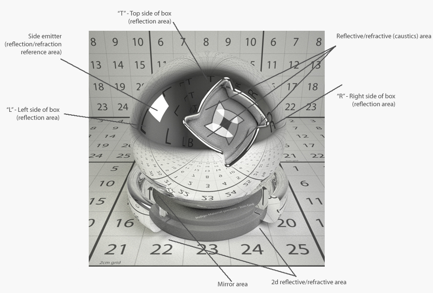

Model is placed inside of the box which have dimensions 1x1x1m . Inside are 2 emitters placed in 2 layers, so you guys can simply switch between them to check material in some more ways.
Every side of the box is mapped with texture with neutral color. Textures works like indicators (see image below).
Of course, scene is not perfect so please, if u find some bugs, feel free to report.

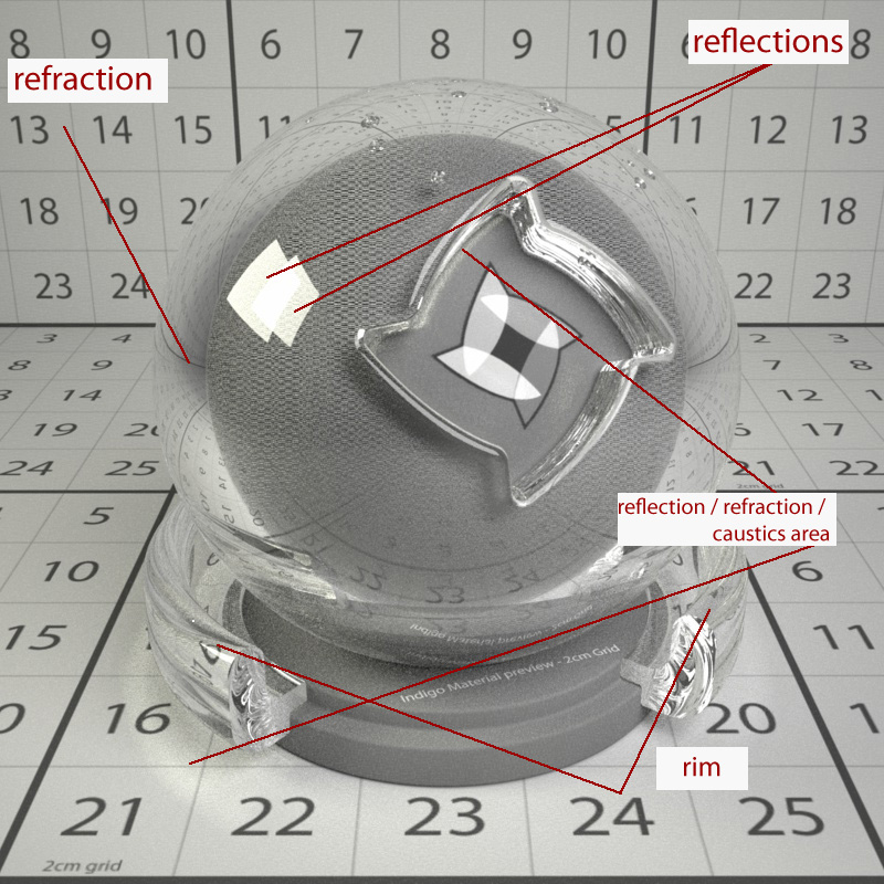

PS : for rendering of dielectric materials (glass, water etc.) i recommend to use supersamples factor 3/4 to avoid fireflies or use MLT. For faster rendering, use smaller resolution.

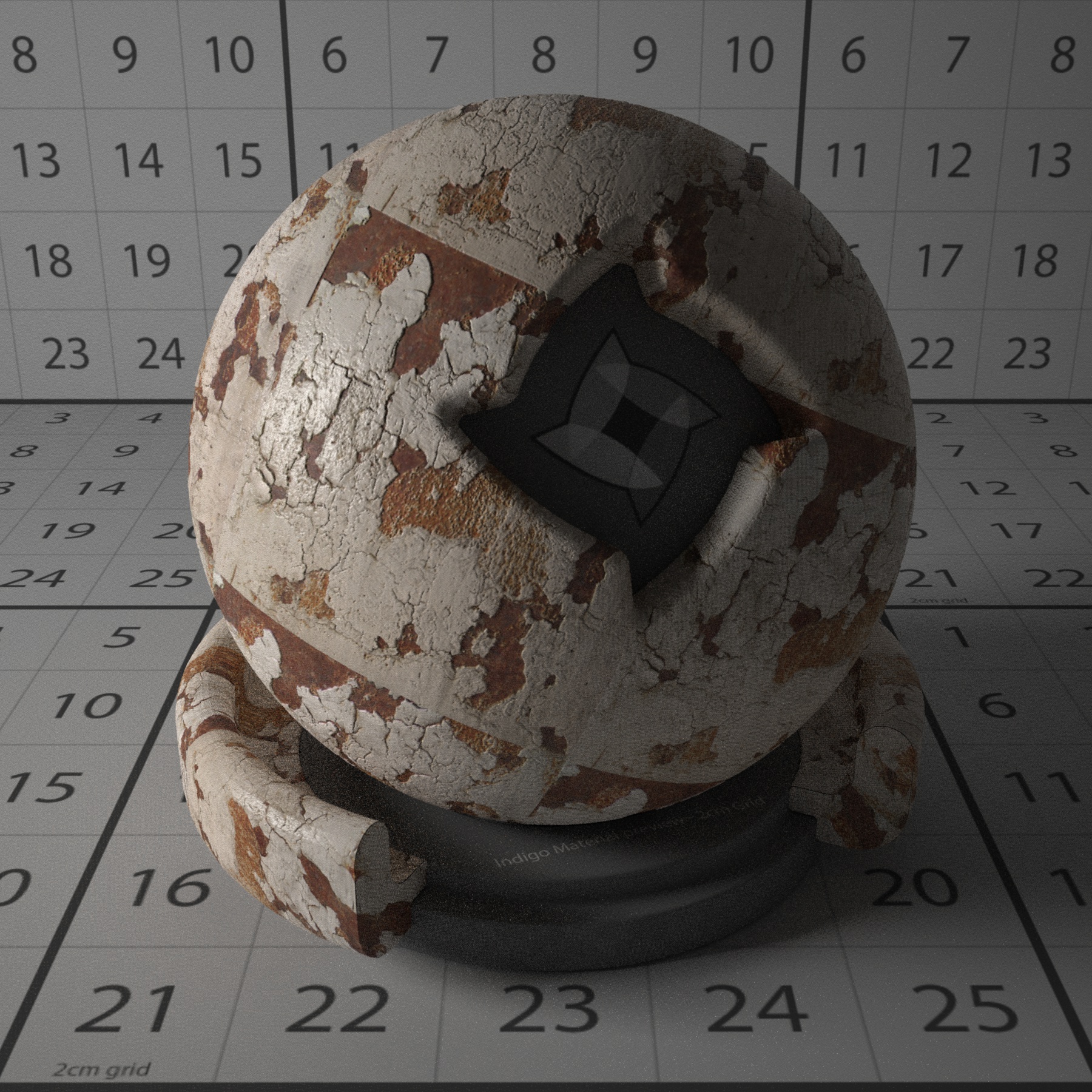

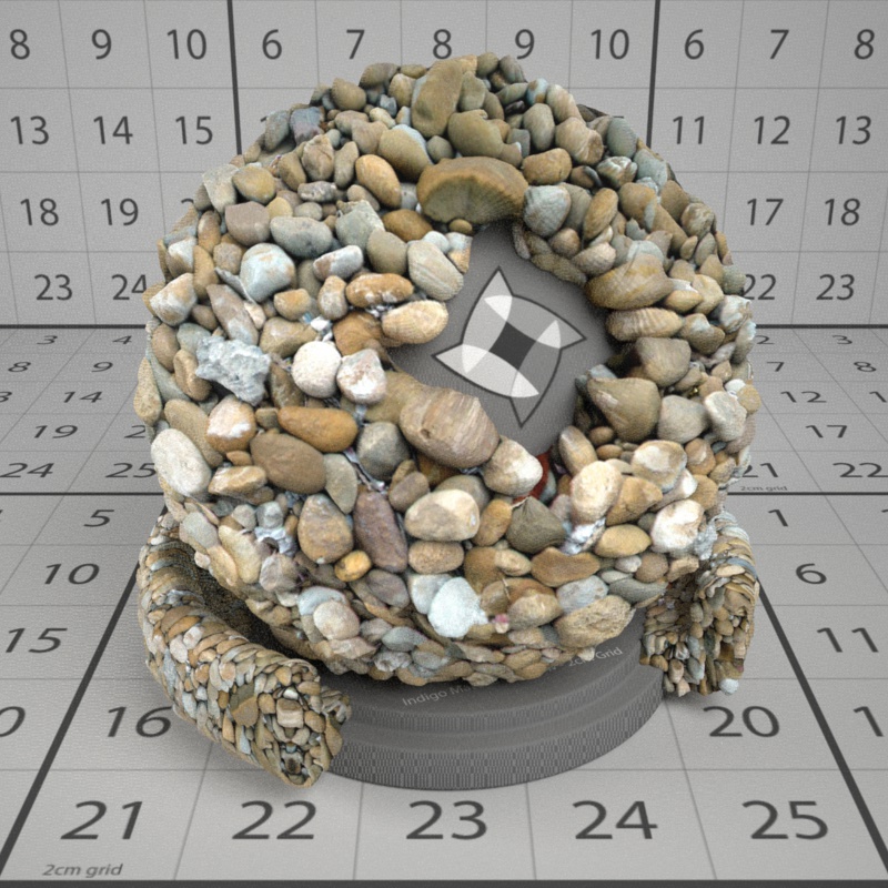

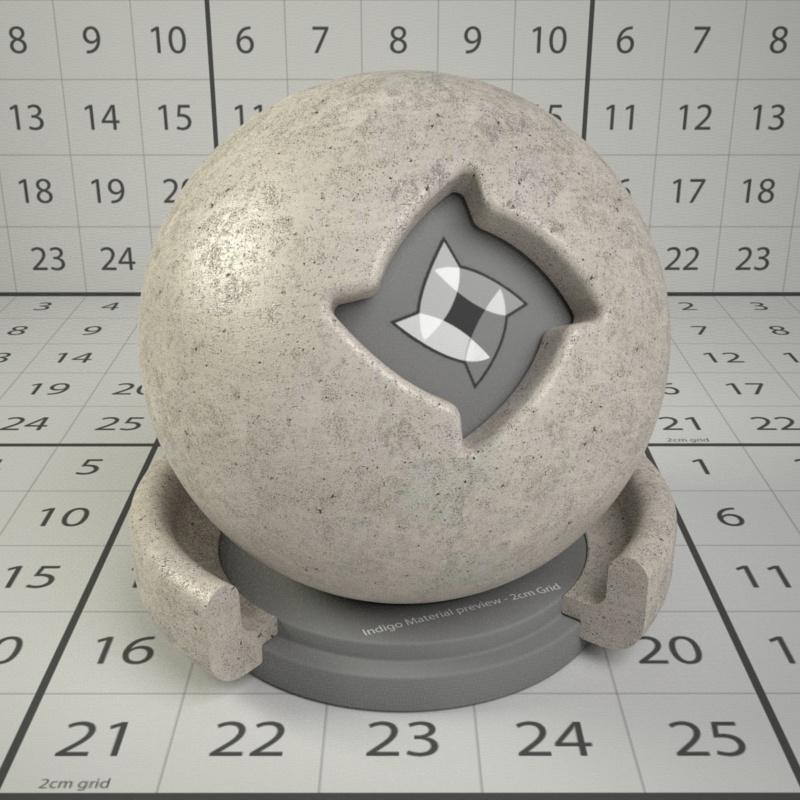

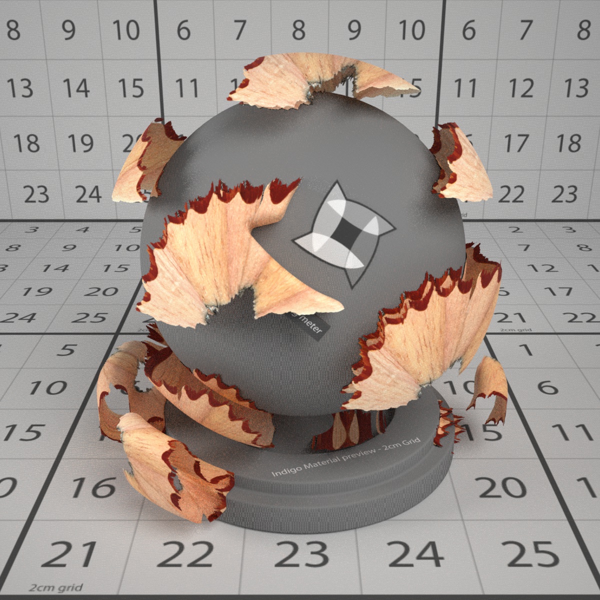

I wish you a lot of fun with that. Some images (scene to download at bottom):

here are some explains how scene works :
