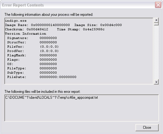

I tried the following-
After pressing the render button in SU, the black Indigo screen comes up & the error message appears immediately. The scene never gets built & starts to render. I went back to SU & exported the scene as igs.
Then I tried to render the igs in Indigo. It does not open either & I get the same result as above.
I also uninstalled Indigo & Skindigo & reinstalled both & got the same result as previously (.14 works & .15 does not)
I have attached partial contents of the error report...I don't have a clue what it means!
Thank you
partial contents of error report

Post by Whaat » Fri Aug 19, 2011 7:55 am
Thank you
Can you please find the two .igs files that were exported by Skindigo and attach them as a zip file to this thread? You should have a name.igs and name-meshes.igs.
