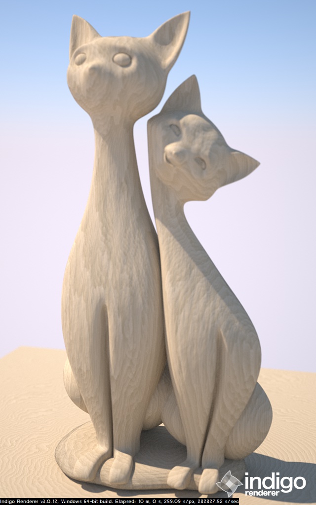

Yes it is similar to the wood texture in Maya (it's volumetric) and doesn't rely on good UVs to be properly drawn.
Therefore you would see no pinching at poles on a normal sphere. Perfect for one-piece sculptures.
Problem is that I wasn't able to get 3d bump, just got to figure that one out. IIRC eval(vec3 pos) real is not an option there.

Actually Lemo, 3d shaders do look better on complex models:
Well I think I have something different to do with IGM's now ...

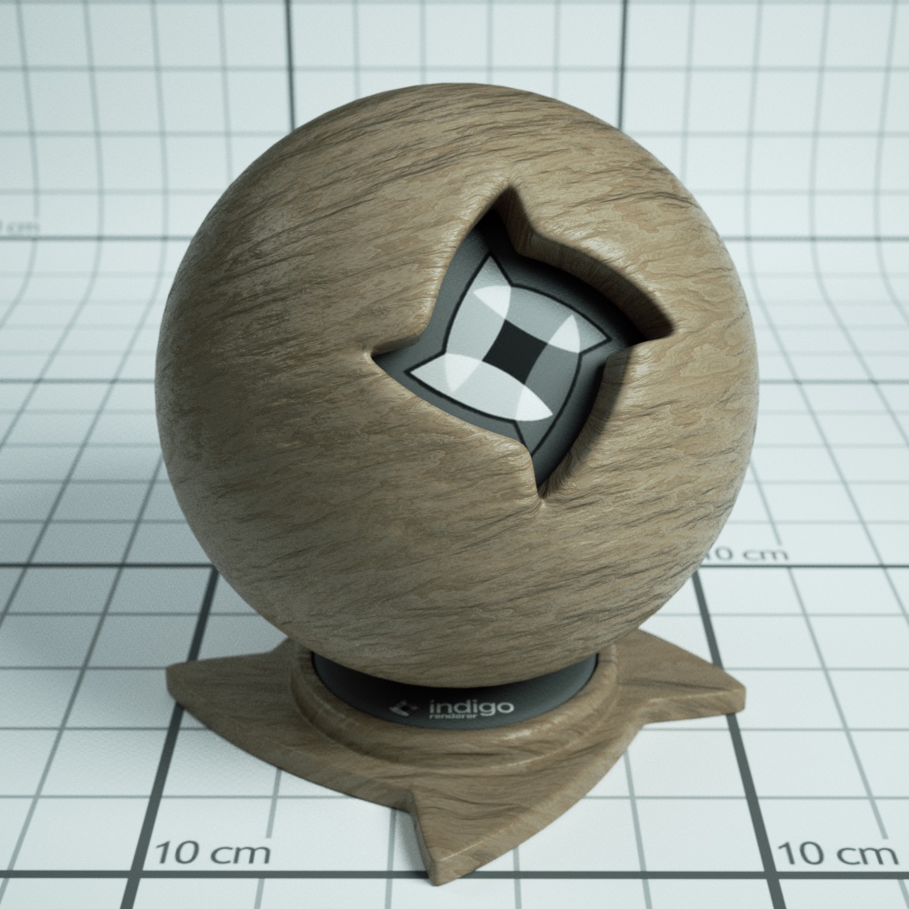

Back to 2d woods, here's my candidate for a release.
You may find that aldbedo and bump have the same beginning in their code, wich can be edited into one channel and pasted to replace its equivalent into the other channel.
Actually the current look isn't my favourite but really it's meant to be tweaked (got a little doc within).
Will make a better one when we have shared parameters
the (not yet) shared parameters:

Try them out !

I'm not sure about the divider in noiseAmount(), might as well let the value free.
Dev's comments are welcome !
Re: ISL woods !
rc4 is too plastic and has to litle black contrasty stripes.
rc5 is deeper.
Perhaps an variatsioon that has some additional blend map that regulates larger quantities between diffuse and phong variatsions.
But the rc5 as highly polished and finished wood looks good.
