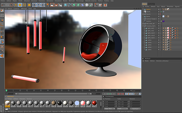

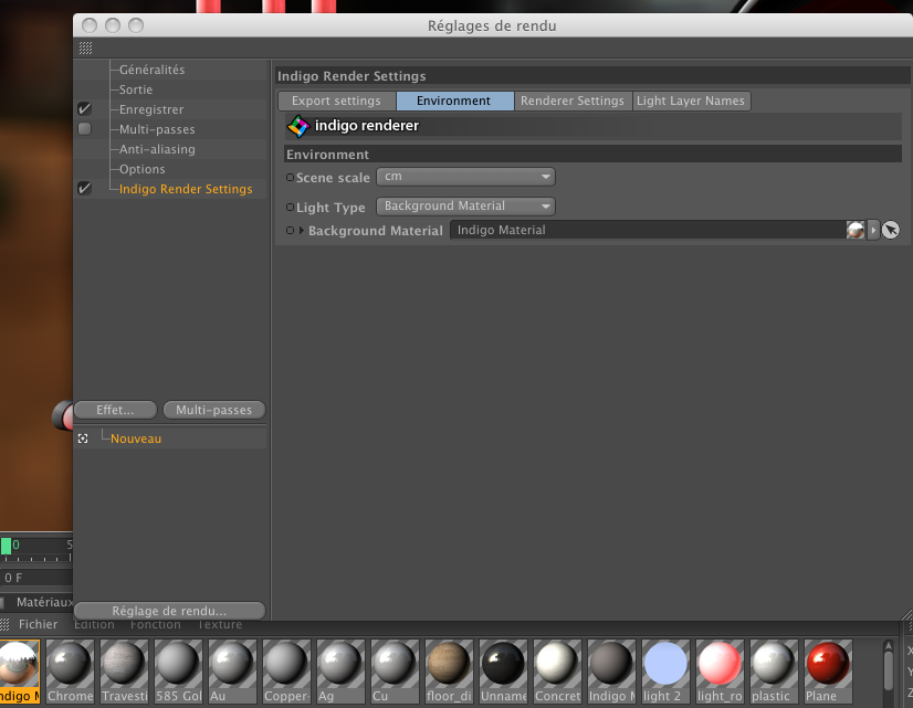

I would like to render my scene using a test exr map. I applied this one (using a material "diffuse") on a sphere that I edited. Then I put in my material the Environment tab indigo (exr). Out when I run an update on my Indigo render exr does not appear. Thank you for your help.

set the emission mode to uniform and the Value for it to 1 million, then you should get a light material that actually is bright ;)

its basicly a issue of multiple light materials having massivly different Limonous Flux (adjustable in emission directly too).
The aligning of light materials needs some trial and error to get some feeling for it,
and isn't that intuitive atm as I think, but usable at all :)

SCHMUMS wrote:It did not seem to work ... do I have to put a tag on the sphere which is used for the background?
A Sphere?! there is no need for a sphere, delet it and don't let your scene be covered by any (c4D based) skies or (for c4d kamera) invisible spheres etc.
SCHMUMS wrote:is what I have to change the value to 1 million on the tag or directly on the materials
There still exists a light tag... don't use it!
You have more controls by defining your light via material... so delete the tag(s) and retry rendering
(your HDRI emission materials STILL needs to be set in the render settings as you shown in screenshot in first post)

sorry seems to the same thing as the first screenshot.
yet I remove the tag, pass the value to 1 million.
I would like to use also provide an image in the background as well as the environment (EXR), is it possible he should use an object in c4d rear plan for the background image?

SCHMUMS wrote:sorry seems to the same thing as the first screenshot.
This is getting to complicated ^^
here is the quickly converted scene, so you see how I managed it.
http://dl.dropbox.com/u/6935848/indigo/ ... itroom.zip
SCHMUMS wrote:I would like to use also provide an image in the background as well as the environment (EXR), is it possible he should use an object in c4d rear plan for the background image?
for a background image you need to create a mesh plane and map your (emitting)image on it.
Most of C4D internal render features like the background Plane isn't working in Indigo.
Most of the faked features also never will work :)
