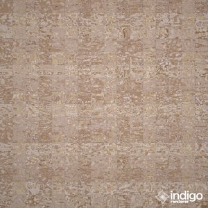

It will be one single phong material, using ISL for its albedo, bump and exponent.

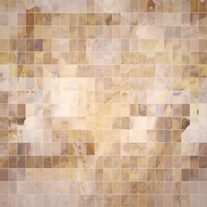

I am already nearly done with the albedo: I would like to increase the randomness in tones distribution (currently dark and light tiles are grouped, depends on tiles frequency though), and add variance in the cement.
It will be easy for the user to customize the reference marble texture (a bitmap currently, wich is scanned over its two dimensions) and the number of tiles, horizontally and vertically. In effect, tiles don't have to be square.
Note that the result will be procedural, wich means that no texels will be visible no matter how close the shot will be.
Thanks to robostimpy for its artwork, and for encouraging us to make our own marble. That may be the matter for another ISL development thread, though not a simple one obviously (I'm reserving myself the right to fly away from that one :mrgreen: ).
Concerning an introduction to ISL, I mean to make it a brand different topic, to start with the basics (I just acquired).

Current albedo below

Below is the reference I used to discretize the fbm's:
http://www.digitalartform.com/archives/ ... tiled.html
Wich gives, under a rather expanded ISL form (and as used in the albedo above):

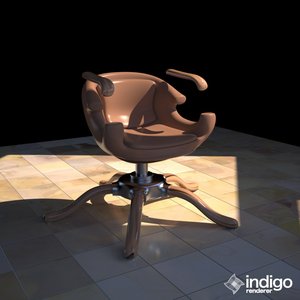

As much as it was a nice mosaic, the variance in the tiles albedo made by no mean a realistic floor. So I am now trying to find a visual balance.
This is currently revealing more of the noises driving the features along with a cyclic nature from within my code. Two aspects I'll be working at. C&C's welcome !
basic test
Most recent version, same ref texture

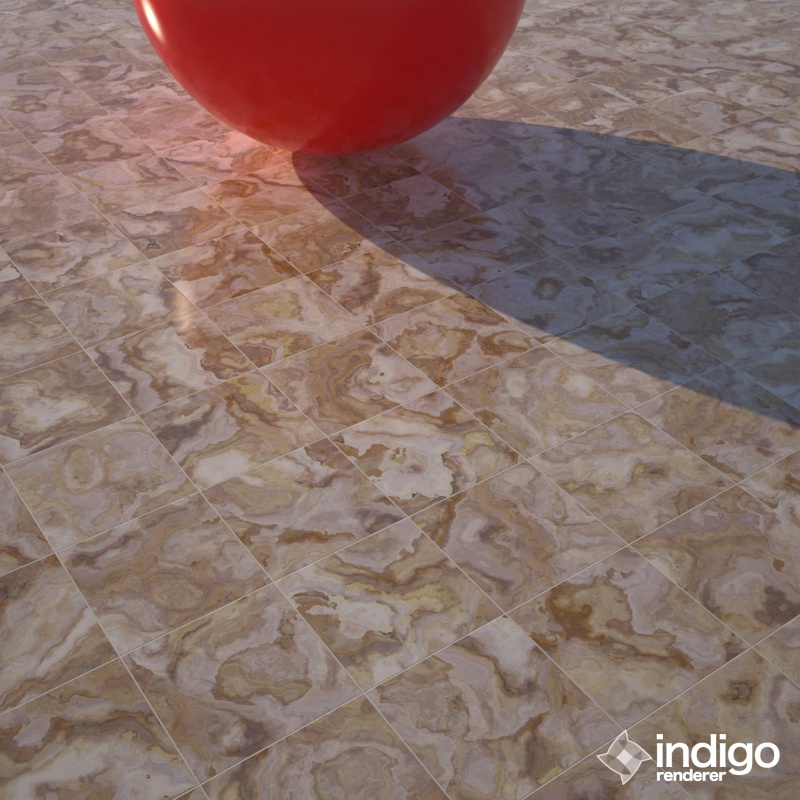

Post by CTZn » Sun May 22, 2011 5:16 pm
Well, that's 99% finished. Copy the code below and paste into a new IGM file to test, material name is tiledMarble. Don't forget to get a nice marble texture and change the path (currently: marble_21_402_by_robostimpy-d34dq4t.jpg) accordingly.
The number of tiles and cement width are easy to configure, however they must be changed into the three material parameters identically, with your lil fingers :)

Actual version
when it was 90% done... open sky, you'll do better.
