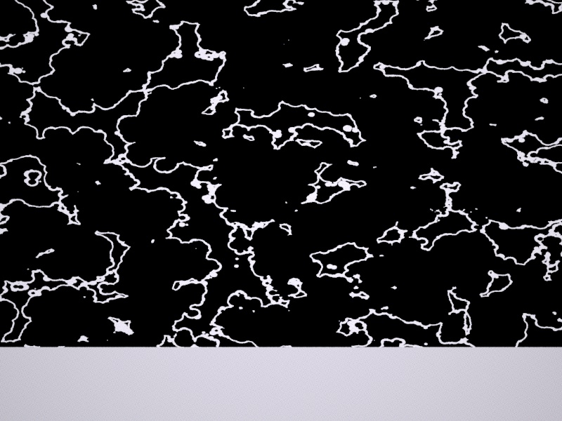

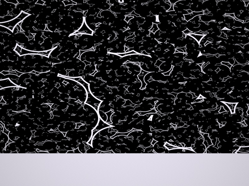

I think i was wrong about the tiling, probably the tile got soo small i can't see it from noise.
Need to move camera closer.
1'st uv layout:
10x 10y times larger uv than 1'st
galinette wrote:There is a UV mapping issue : the UV mapping from both sides are not the same, generating two superimposed stained glass cell patterns
The random color is not working for photo collage. Did the not matching 2 sides got fixed, will it work if i duplicate 1 plane and change normals outside and move over the glass medium. Then i make glass parts to diffuse transmitter to speed up if it helps.

So it seems to work as expected, for infinite non repeating mapping! That's the beauty of procedural materials.
In the above picture, it seems you have two different UV sizes for the two faces?
The photo collage is not made with the database material. It was a custom one.
The mismatching UV was only a problem of modelling and not a problem of material definition. It's only because I messed up the UV in sketchup (which I don't like for UV mapping). Should not happen with the DB material.

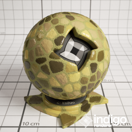

Hi whaat,
I started working again at that shader. Here is the last weird result! Still needs some tweaking...

Re: Voronoi ISL Shader
Post by StompinTom » Wed Apr 13, 2011 3:57 am
galinette wrote:Hi whaat,
Sheesh, I should just hire you to make all my materials for me.

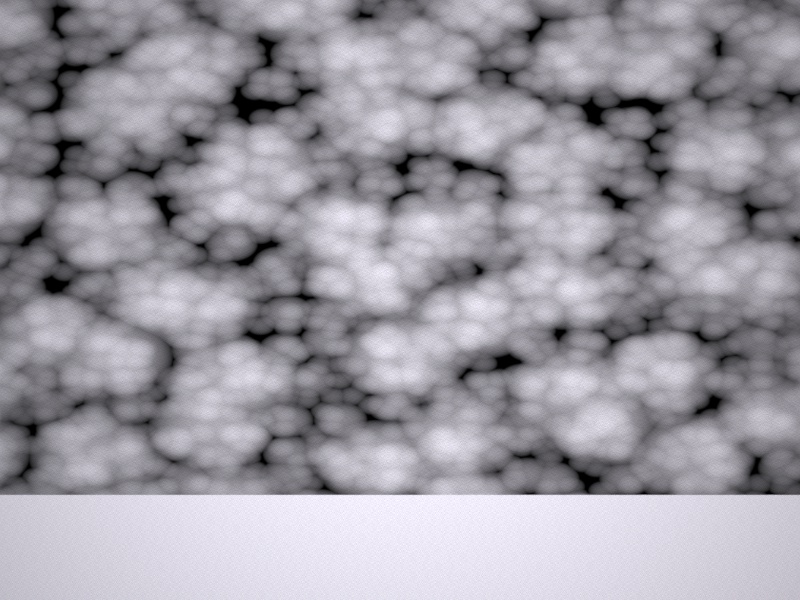

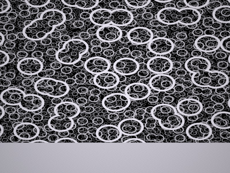

Implemented a basic Voronoi function.
Messing around with it:
The ones with rings are based on pulse()ing the distance from the voronoi cell points. There's also 4 scales of Voronoi regions mixed together :)
