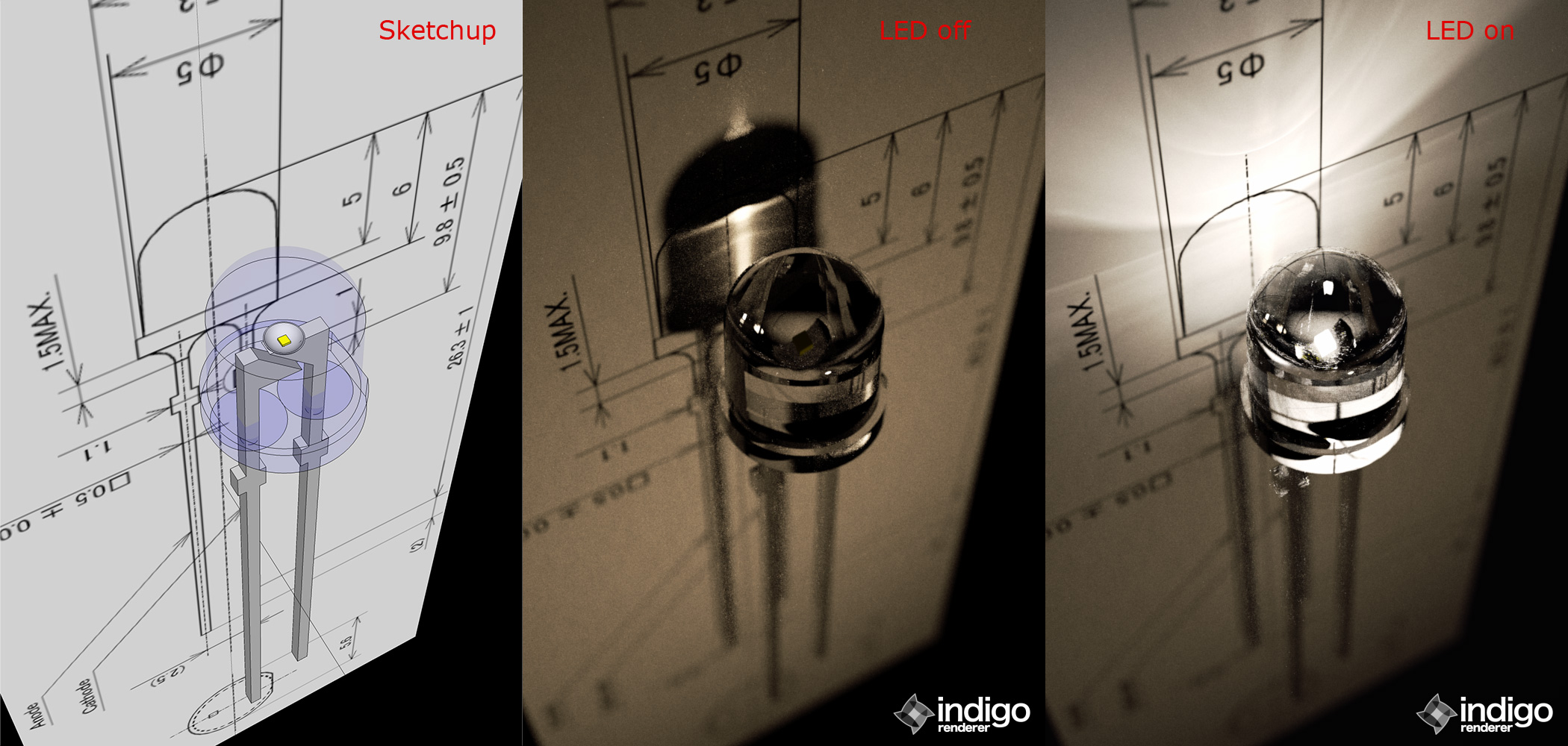

Here is a little LED test:
left: Sketchup model with the original picture
middle: a little surrounding light for illumination of the whole picture
right: LED with active emitter
Render settings:
BiDir MLT
2 light layers
24h rendertime
surrounded by exit portal
Is there a chance to get better (faster) results of a scene like this?
Cotty
Render settings:
BiDir MLT
2 light layers
24h rendertime
Cotty
Wow, nice work cotty, I remember seeing a thread about leds on the maxwell forum along time ago, it was quite an extended discussion....
I think leds will always be pretty tricky to render in an unbiased engine, not a lot you can do to speed it up without losing quality somewhere.
Nice !
Eventual improvements may come from rendering modes/options. Fiddle with that, w/ & w/o Glass Acceleration, bidir etc.
PS: the legs might be meant as cylindrical, if I grant the dotted lines to be axis. Ah no scratch this, I overlooked the section from the top view
I don't believe that there might be any improvement from that, did you manage a test prior Cotty ? The scene bounding box itself is doing the trick, exit portals have no use that I know of while no environment is used. However if you did use part of an environment for the outer lighting that may be correctcotty wrote:surrounded by exit portal
Thank you for your suggestions! I have tested with an without exit portals and you are right, there is no noticeable difference. The use of exit portals without an environment leads to an error message "Can not use exit portals without defining a background material. (constant, sun/sky, environment map)" and I turned the environment on without using it (surrounding box is closed). I have already imagined that this would not be the best way.CTZn wrote:... did you manage a test prior Cotty ? The scene bounding box itself is doing the trick, exit portals have no use that I know of while no environment is used.
Because of the great render time I didn't change the other mentioned parameters yet...
Cotty
...a light inside solid glass? I don't think you will ever notice GREAT speed improvements, I fear..
BTW this is an interesting test Cotty! No IES profiles used, I assume.
I saw that most of the times using a proper IES profile will save you some..time! You could try that!
Let us know!
Let us know!
I tried to produce a realistic picture of the LED itself, so I put the emitting cube in the glas as produced in reality and you are right, it is a comparable slowPibuz wrote:No IES profiles used, I assume.
If the goal ist only to reproduce the light of the LED, the IES-way would be much faster and more accurate (I think) because the LED-manufacturer show the directional characteristic in their documentation but not the inner construction of the LED...
Cotty
