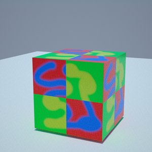

Try using Indigo's Material Editor to make the Blend then refer to it from Blendigo as an external material type.
For example to test this out I created a 3x Blend material in the editor and then rendered a simple cube using it. Worked with no problems
3x Blends in one material
The simple scene using the external 3xblended material
and finallly the Indigo .pigm material file so you can load it into the Material Editor and Blendigo to try it for yourself
TestExternalBlend.pigm
(25.7 KiB) Downloaded 304 times

I've had to deal with this before and requested a change to how it works, but it's a matter of naming the material the same across the board - your internal blendigo material names have to exactly match the material names in the external material .igm's that you are referencing.
what I think would be more user-friendly (if it's at all possible) would be for blendigo to do a check for the external .igm material name and use that for blends. that way you could easily swap blended external materials without having to rename your blendigo material or double check that everything matches.
