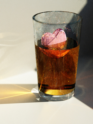

Post by chiataimakro » Tue Dec 28, 2010 2:29 am
still too noisy after 14h rendering on a PentiumE5300 and a Core 2 E7500
MNCR max is not a good option
Post by CTZn » Tue Dec 28, 2010 6:05 am
Yes that's very noisy, crying for an inspection :)
Any chance that you could share the original scene file chiataimakro ? A blend or skp or so, depending on your host app. I guess some users do like the game of optimisation, they may help you... Myself am off my computer for a couple more days (and using Maya).
Or, pack the scene with Indigo into a PIGS file, but geometric checks may be harder to run. I'm sure there's something to do with the rendering time.

chiataimakro wrote:still too noisy after 14h rendering on a PentiumE5300 and a Core 2 E7500
No no, max MNCR is very good. Looks really nice. :D
but turn bidir of, us MLT path tracing.
