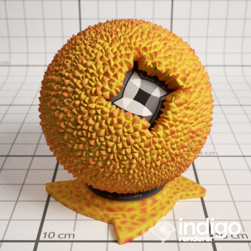

A straight border between cells you mean ? Look, this base shader is already a great thing. Then, shifting the UVs with another noise func plus a simple condition with the displaced distance as input would be enough in most cases. With a fbm at a matching frequency, one can trick tiles into variated shades (works better with large gaps though)... but, bring us all the candy you want with :)
source: http://www.google.com/imgres?imgurl=htt ... CDoQ9QEwBw
Looking at those fruits, I'm noticing that the point value is dependent on the e:smallest cell dimension... hihi.

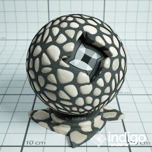

Here is a small update of my development of the ISL shader.
Procedural stone wall (in development...). The stone look plastic but I did not focus on the stone material yet, only on the shape generation.

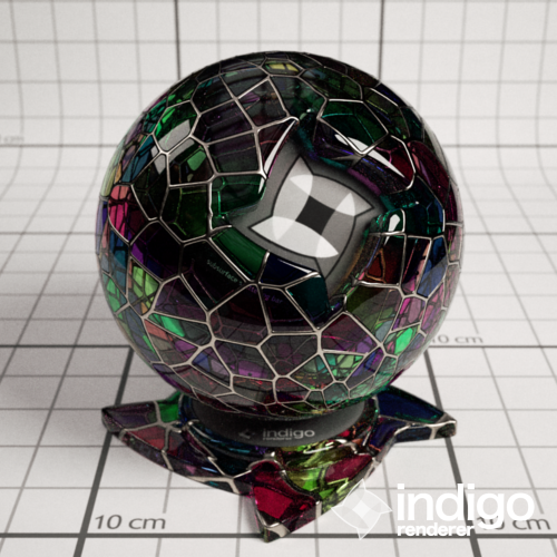

I'm also working on a stained glass

Re: Voronoi ISL Shader
Post by CTZn » Thu Nov 04, 2010 12:59 am
galinette wrote:The letchee is baking....
Aw... now that's seduction :lol:
Nice pick with stained glass !

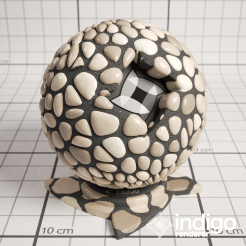

Just a little update with displacement:
Post by CTZn » Sun Nov 07, 2010 1:38 am
Nicely scaled for rustic water places: public baths, a fountain or something akin, even for some low-grade garden sculptures :)
