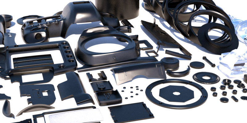

As my first project on this forum, I'll post some renders of this awesome camera, using Maya exporter.
For now, the modeling part is almost done, and I'm going to start working on textures and materials.
In the meantime, I'd love to hear any tips on how to render it correctly, especially the glass of the lens, which is going to be the hard part I guess.
All the glass elements are accurately placed, and I may also do some optical tests, with lasers and other fun stuff.
Now I just need a screwdriver to reassemble all that :p

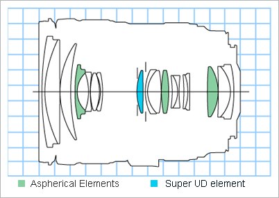

Btw the lens I'm doing is the Canon EF 24-105mm f/4L IS USM
Quite a nice looking one, with eighteen! pieces of glass

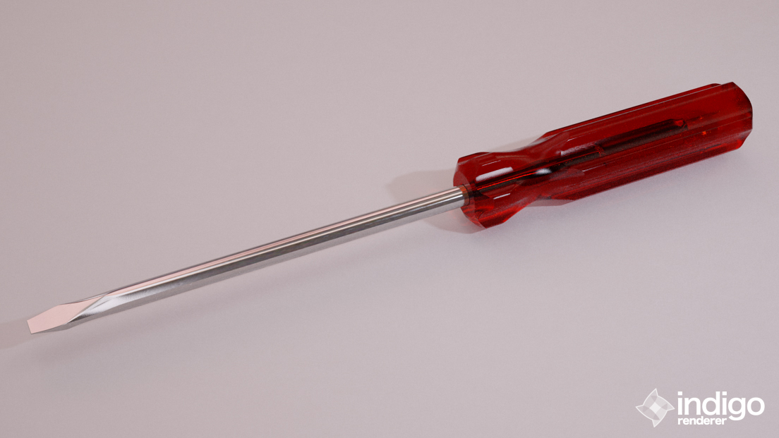

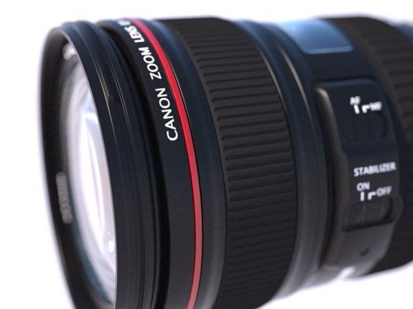

Okay, thanks to Dag's screwdriver ^^ I could assemble the lens, and start to play around with some textures.
The materials don't look as they should yet ... but a strong depth of field is an efficient way to hide that :p

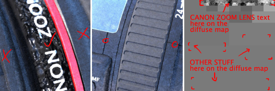

The bump I tested is fractal > bump2d > indigoShader
Normals are okay and I'm running Indigo for Windows, without subdivisions for now.
I'm using a single texture file for several elements, and apparently the exporter only bakes one (with the corresponding area of the texture).
The result is one of the lens rings with the fractal bump, and the others with random bump straight lines.
What I would need I guess is a single baked bump texture covering all the area, that Indigo would use for all the elements of the lens, as I'm doing for the diffuse texture.
Anyway, as for the instances it's no big deal for now, because it works just fine with a file node bump,
and I'm probably gonna use a file in the end
Here are the renders, with the baked bump on the right.

I see now, that's indeed a known bug. The action is intended to avoid baking multiple time the same texture but that's wrong when it is applied to multiple objects: it should be evaluated against each of them.I'm using a single texture file for several elements, and apparently the exporter only bakes one (with the corresponding area of the texture).
The workaround for now is to duplicate the texture node to be baked once per object/UV set, in order to force its evaluation.
Thanks for the report, it's on the list now !
Note: In general, once a textured was baked one can tick the "Freeze Evaluation" button to use the last baked version; but then, you shouldn't change the "Virtual Plane" state because that would change the expected target name on disk. I will disable this last UI control when a texture is frozen.
