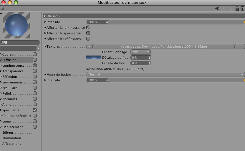

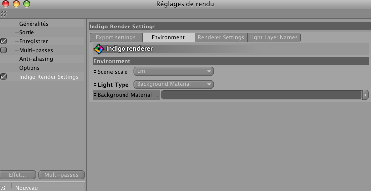

Fused Hello, thank you for your help, but it does not work. This is what I do:
- I create in my c4d scene as an object back plan
- I create a new material in the channel luminescence I load a HDR.
I assign this material to the object plane back I add a tag light.
After trying to glide through the Environment tab of the preferences Indigo renderer but it does not work.
I attached the screenshot.
thank you in advance

as for me I found I was not as it should. However I have a problem I've encountered several minutes ... there is a demarcation in the middle of the image, how to address them. Thank you

Hi SCHMUMS,
the artifact you're getting is due to the very large scene scale. We've improved the precision somewhat since 2.6.1, that could help a little - keep an eye out for the next release!
