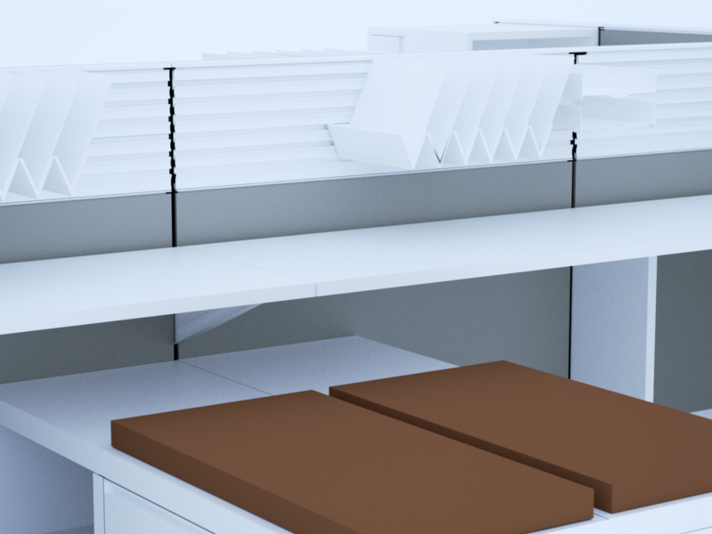

Post by tgrawe » Sat Feb 06, 2010 3:26 am
Not to be dumb, but how do you check the UV coordinates? I can get the window to render in 3DS (see attached 1) but when it goes to indigo it looks like the attached 2. The orange material is supposed to be the orange checkerboard material in attahced 1. Thanks alot for your response. Some days I feel like I've got it, then I don't.

Re: Creating Materials
Post by suvakas » Sat Feb 06, 2010 3:32 am
tgrawe wrote:Not to be dumb, but how do you check the UV coordinates?
Search for "UVW Map" modifier under Modifiers list and apply it to your model.
You may also press down the "Show map in viewport" button in material editor to get real time feedback in of your texture in Max viewport.

Post by tgrawe » Sat Feb 06, 2010 4:04 am
Is that the reason why the map is not rendering in Indigo? Attachement2 is the rendering from Indigo. I will try the UVW map modifier. Is that a global change in 3DS, or do I have to apply that to each object seperately? Thanks again for your response. Your program has really openend up another door on my renderings. Thank you!
Post by suvakas » Sat Feb 06, 2010 4:51 am
That could be one of the reasons. Your Max screenshot doesn't tell me much cause I can't see if the map is correctly applied inside Max or not. Try to render it with scanline or Mentalray and see if you get the same issue.
Generally only primitives have automatic UV coords. You have to use some sort of UV modifier for everything else.

Post by tgrawe » Sat Feb 06, 2010 9:33 am
Thanks Suvakas, I've got the textures to come across (see attachment 2). I just have to play around with the maps. Thanks for the direction. It helped me out alot.
