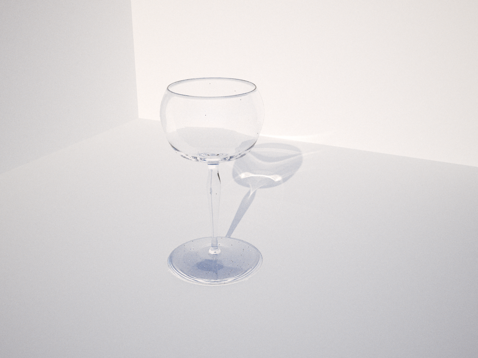

Yesterday i changed my main program from SketchUp to 3ds max 2009. I dont know if it is a tradition or not, but my first render was a glass object :) I have 3 questions for you guys:
1-) Why do i see this annoying black points on my glass? i used Indigo Glass/SSS (Maxigo) with default values on glass...I tried to delete them with Neat Image but it was useless. How can i get rid of them ?

Black may be because some normals are backwards.

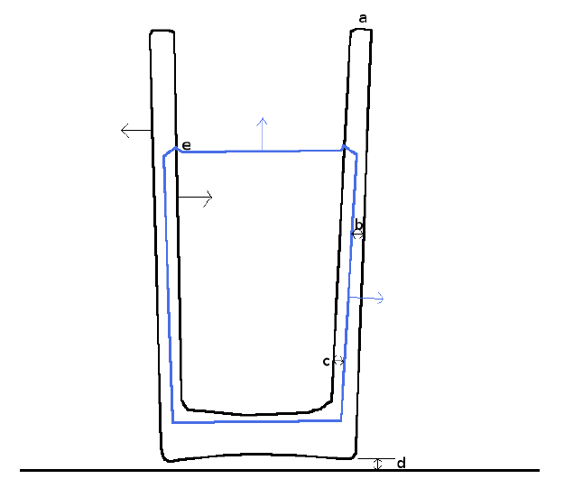

Here's the schema of how you should model liquids inside glass for Indigo (taken from Indigo Technical manual).
Modelling Requirements:
a) need sufficient polygonisation of the curve here because sharp edges cause shading normal
artifacts. For example 10-20 points may be needed on piecewise curve.
b) distance should be > 0.2mm
c) distance should be > 0.2mm.
Note that while the distance between the glass and water surfaces in the walls of the glass needs
only to be greater than 0.2mm, it should probably be about 1mm, depending on the width of the
glass
d) distance between glass and ground plane should be in range [0.2mm, 1mm]
e) meniscus should be modelled
Addtionally:
f) all geometric (given by tri winding order) and smoothed normals should be as labelled.
g) total number of triangles is expected to be in range 10000-150000
h) surfaces should be two-manifold and closed (not self-intersecting).
i) liquid and glass should be assigned different materials.
j) part of the surface of the liquid component should lie inside the glass as shown.
k) The model should be created in units of meters.
l) The glass medium precedence should be greater than that of the liquid medium (because glass
displaces water), which in turn should be greater than 1.

I did what you told me, i checked the manual and i did exactly the same...but still i see some black dots :)
Why?

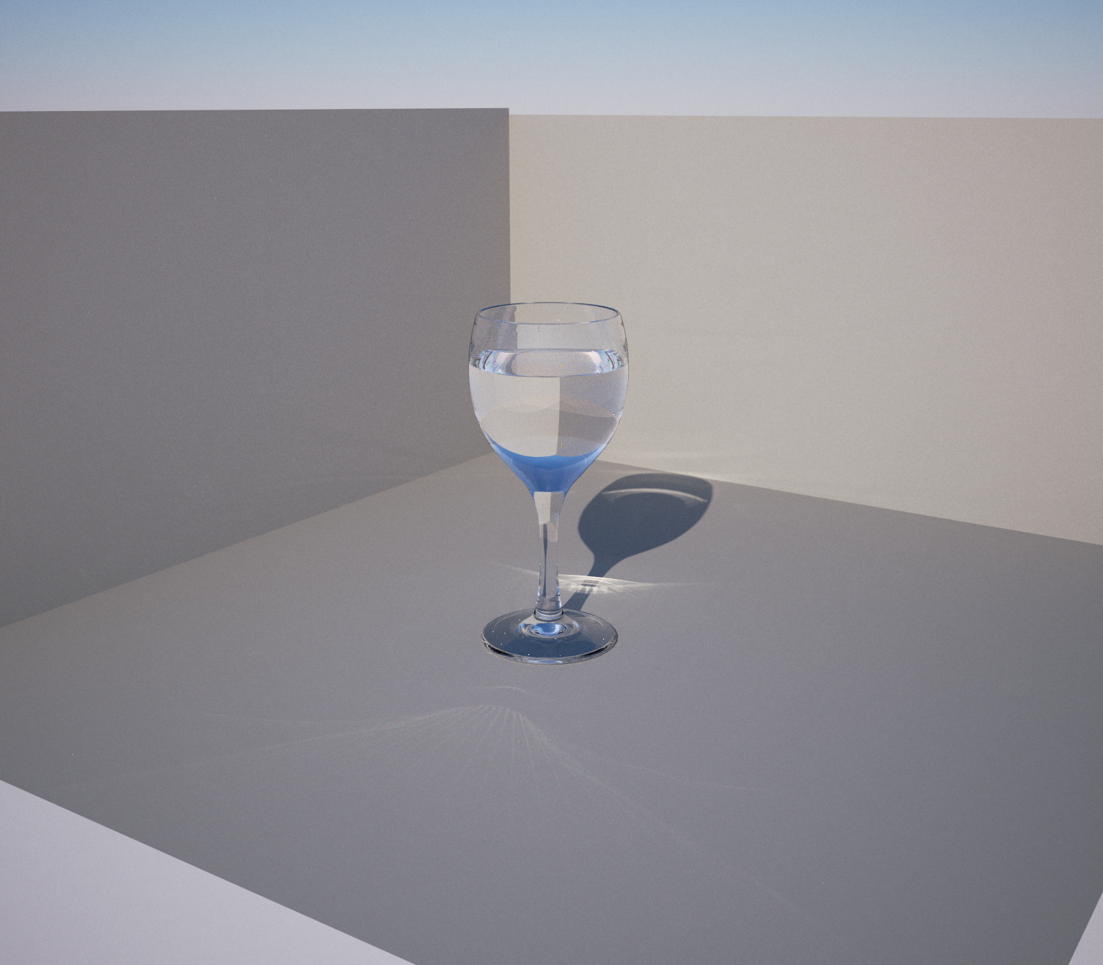

I changed the method but i think its still the same...When i click to Aperture Diffraction these black-white dots are getting shiny

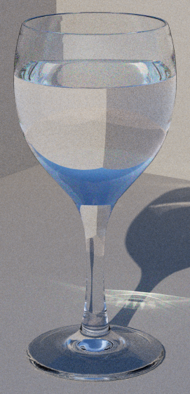

Edit: i changed the width of glass and water, i think its better now but as you see there are some white dots still... Maybe its because of my drawing, strange...I will draw other objects, if it will be the same again, i ll go crazy :)

Post by Otk » Mon Nov 16, 2009 1:08 am
@psor
As you see, your solution solved my problem flawlessly. It was 2 by default, i changed it to 4 and made a render and then there was only a white point, then i changed it to 6 and its perfect now : )
Thank you very much !!!
Regards
