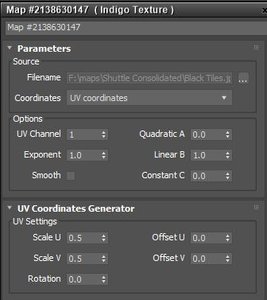

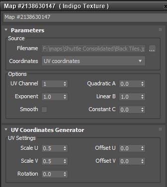

Does anyone have any information on this node? Its not in the very limited manual for 3ds Max. At least the one on your website. Im trying to adjust the strength of bump mapping but the standard Max adjustments just don't work. I was wondering if the Quadratic, Linear, or Constant settings are maybe what I need to adjust.

Linear B will adjust the strength of the bump map.

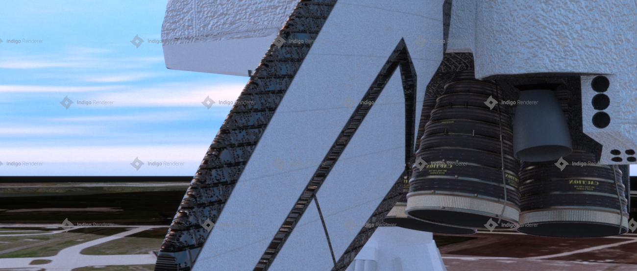

Thank you, but at .001 strength, its still way too strong. As you can see in the image, even at 4 decimal places with a Linear B value of .0001, the bump mapping for the rudder and the texture of the body of this shuttle is still off the charts.
