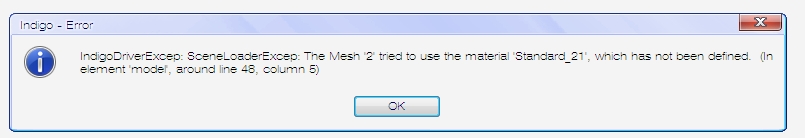

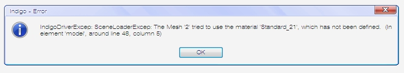

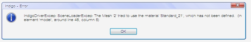

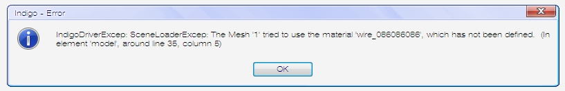

hi
I post all the screen shot of the messagefor any export possibility given by maxigo. So if I separate the geometry and give to any part an simple indigo mat all run well.

Post by suvakas » Thu Mar 05, 2009 7:54 pm
Yes, seems like the materials are not exported from Max.
But that's all I can say. I juggest you to wait for the next Maxigo version.
It could solve the issue.

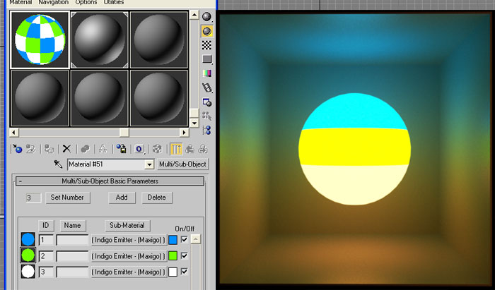

You are in right, the exporters run well with the sub/objcet mat, I encontered this problem only when an indigo emitter is present in one of the sub mat slot.
the exporters can't recognize the tipe of mat when this is an indigo emitter.
have you any idea how too solve this problem? standard emitter don't emit nothing.

Post by suvakas » Fri Mar 06, 2009 1:21 am
Well.. in current Maxigo the emitter material is actually not a material (internally).
Emitter in Indigo used to be a special type of mesh and it became a material only recently. It is presented as a material in Max because it is more convenient to define a meshlight like that.
Maxigo doesn't currently read the emitter as a material. So nope, you can't use it inside multi materials. You can only apply it to whole mesh and then the mesh gets exported as emitter type with no material at all.
One workaround could be to detach the faces you want to emit light from the main model and apply emitter material to them.

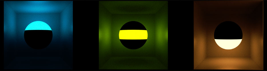

Post by suvakas » Tue Mar 10, 2009 9:54 am
I just finished converting the old emitter material into a "real" material.
So in next Maxigo version you can sure use emitters inside multi-materials. :wink:

I forgot to mention - light layers will be supported too (finally).
Post by OnoSendai » Tue Mar 10, 2009 10:46 am
Ah, even cooler.
And that last render could be a nice minimalist art piece :)
