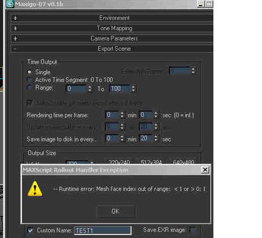

I will test the new verson of expoter, but whit this scene indigo send me this message..what is it?
filippo
stavo testando la nuova versione dell'exporter ,ma indigo mi da quest'errore come mai?
filippo
errore 2.JPG (35.99 KiB) Viewed 5012 times
Post by suvakas » Sun Mar 18, 2007 4:35 am
Well.. I don't know why you get this :lol:
Check what is written behind "Currently Exporting:" line above the process bars. (right after where your screenshot ends). It should show the name of the model that is causing the error.
Suvakas

I have 2 problem...the first is the crash of exporter,
but I kill it to resave the file 3ds into rhinoceors v4!!!the second problem is the crazy camera..I post 2 image the first it's Indigo 0.6..the second indigo 0,7..........in the zip file there is the scene.sorry for the bad quality of the file....

Post by suvakas » Mon Mar 19, 2007 2:44 am
Ok. I checked your scene. Are you sure this is the "fixed" scene?
It has vray materials + vray lights + mental ray light + models without faces and you still keep using inches. Indigo uses metric units. The correct scale for inches should be 0.0254 or something like that. But safer is to convert your scenes to metric units. To mm for example.
So my advice is:
Lose all the vray and mentalray stuff
Lose all the models with 0 faces
Convert the scene to mm
Use scale 0.001
Sry, but at the momet the scene is a big mess.
Suvakas
Ps. I just noticed, that there are things missing from 0.6 image. (like window frames and etc)

Post by suvakas » Mon Mar 19, 2007 8:00 am
OK. Gotcha ! I thought that the scene you uploaded is ready to render in Indigo. I was too lazy to remove the vray stuff myself, sorry :lol: So i didn't really try to render the file myself.
Anyway. I'll try to release the new version of Maxigo soon. Maby that solves those mesh errors.

Post by Jonshi » Wed Mar 21, 2007 3:51 am
that problem occur in Sketchup too when you import a mesh into max..the problem is a ghost poligons don´t exist ....delete these object and the export will run ok..
