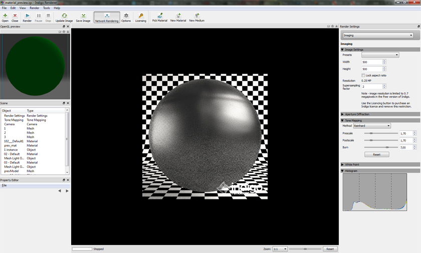

Here is how it looks in Indigo, you can even see that the opengl preview shows the green diffuse.

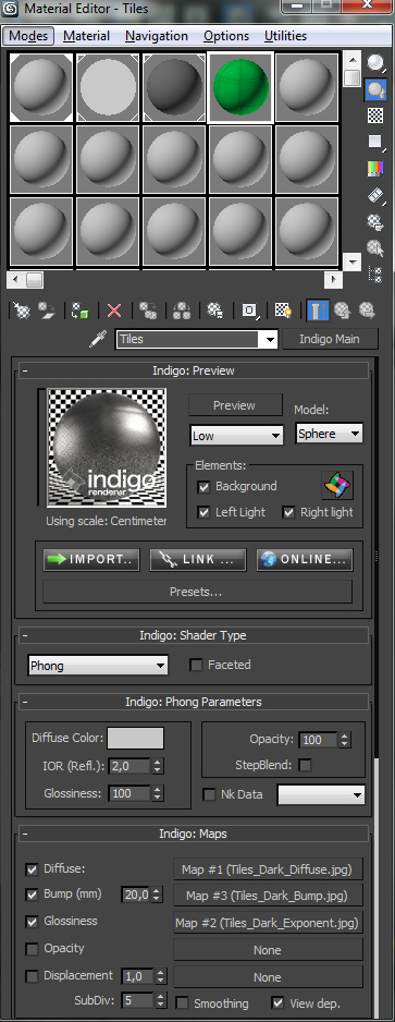

Here is a screenshot of the material settings.
