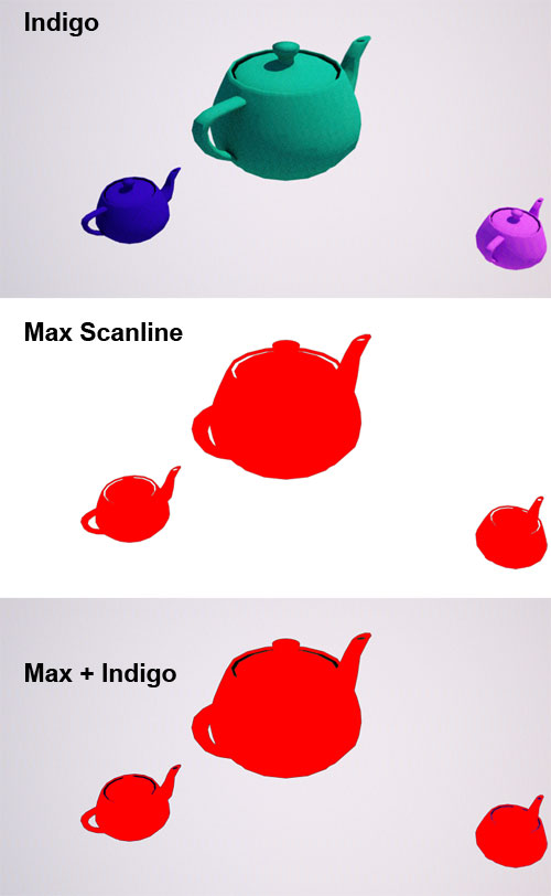

losbellos wrote: camera doesnt match withe the max cameras, there is a cropping.
What cropping? For me the camera seems to match perfectly. See the image.
