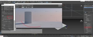

hi everyone.
It does not work.
how motion blur works ?
It does not work.

Re: Indigo Motion Blur (3dMax)
Hello! Nice to have you here!

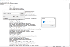

Motion blur works in conjunction with lots of parameters, mainly related to the camera. What I can tell you with that scene you posted is that you have to watch out for the scene size, it seems like your camera is not focusing very well. Besides that, I can't tell you that much, since I use Cinema 4D for the main platform. If it's plugin related, maybe you could mess around with your scene file, and edit it in notepad, to check if there's is a boolean somewhere, that states Motion blur=true, just to be sure.
Hello thesquirell!
Thanks.
But Cannot find "Motion Blur" ...
Thanks.
