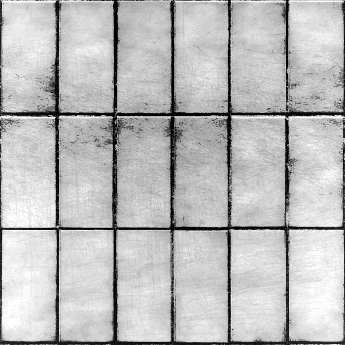

I have had this problem for a little time now, but have not taken the time to post on the forum yet.
When I am making scenes and materials, it seams like the diffuse and maybe the exponent texture get's ignored, bump seams to work.
I have tried with both tga and jpeg same problem.
Material settings: A phong with IOR of 2 and 100 in glossiness.
Here is an example.
Diffuse(Made it green to show it better, since it was dark to begin with) Exponent: Bump: Here is how it looks in Indigo, you can even see that the opengl preview shows the green diffuse.

Here is an example.

The issue with Maxigo 2.6 and Indigo 3.x is, that I tested some texture smoothing stuff in 2.6 and forgot to take it out. It adds smoothing tag to every texture (including diffuse) and while it works with Indigo 2.6 (textue smoothing not supported), all textures turn to greyscale in Indigo 3.x.
