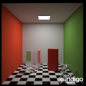

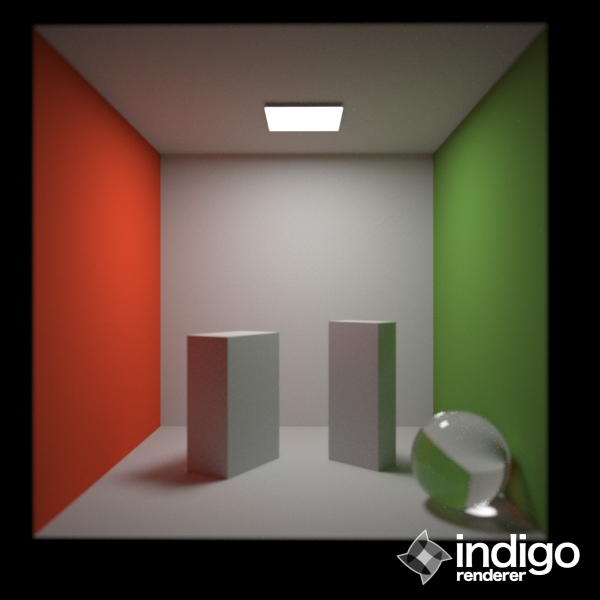

First litle test...It's work very well the interface it's in max style..I really like
Render time for render 1 e 2 it's 3m.
in the 3 render I don't have a render time max it's stop and I failed to save the file, I think this has happened to indigomax, why I closed the render buffer while render advanced and I open the render tad immediately
In the 3 render autofosus it's on, and the target of camera it's in center of the red cube
In the material don't work a bottom to add a map in the side of diffuse colore, it's work in the list of map
thanks
