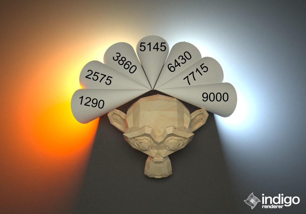

Blackbody makes for great lamps especially since you can look up on google at which temperature they usually get and the input that into the material settings. As far as I know, the lower the temperature the "bluer" tint you'll get where as the higher the temperature the more "orangy" it'll get.

Here's the result (rendered overnight, almost 6000spp), you can clearly the three lights (orange - blue - white)

Well in Fact a lower temp more "red" will be the blackbody
