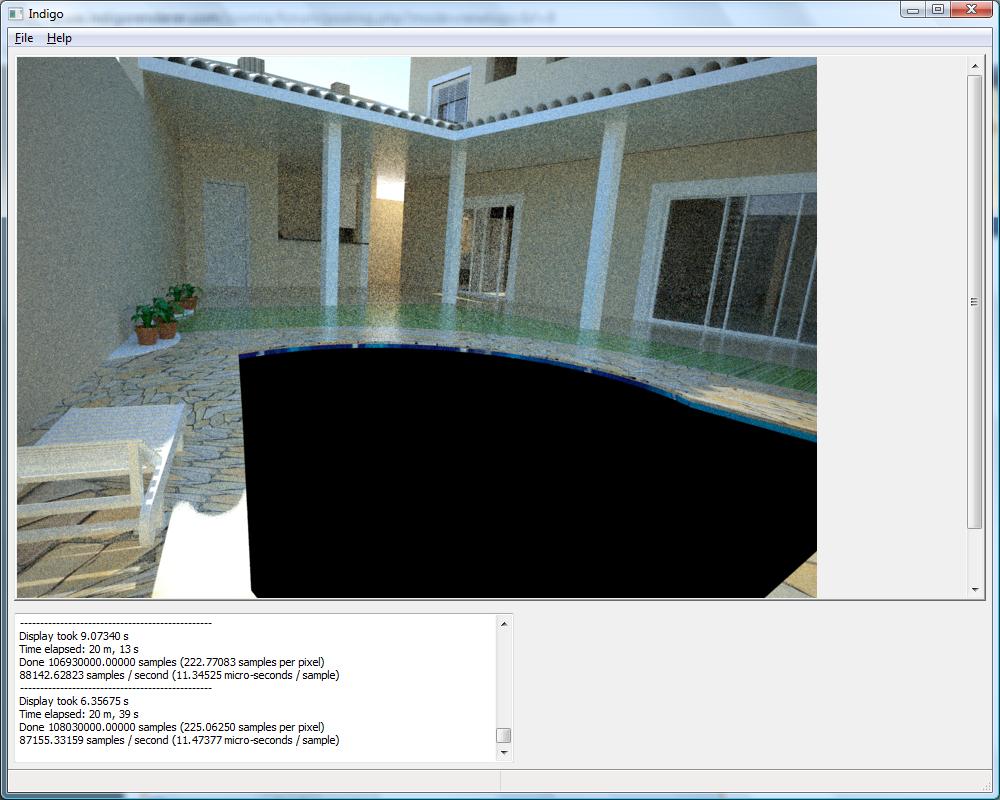

Hi guys!
I'm having a issue with Indigo rendering, my water is black!!!
I already tried almost all. In yafray my water is fine, but in Indigo my water is black.
Any idea?
Thanks
Cris

1. Check the normals of your water object.
2. Is the water object volume or a plane? It should be a volume filling the space water normally would and made slightly larger than it's container so that it intersects with the pool walls/floor.
Post by Borgleader » Sat Jan 31, 2009 3:02 pm
WytRaven wrote:1. Check the normals of your water object.
Yeah check normals, and the volume of your water. because anything thats transparent and with a different ior than air without any volume has a chance of doing that.
CrisRCM
Posts: 13
Joined: Sat Jan 31, 2009 12:16 pm
Post by CrisRCM » Sun Feb 01, 2009 1:42 am
Perfect! Normals was the key.
I'm doing a new render and I'll post here afterwards.
Thanks WytRaven and Borgleader!

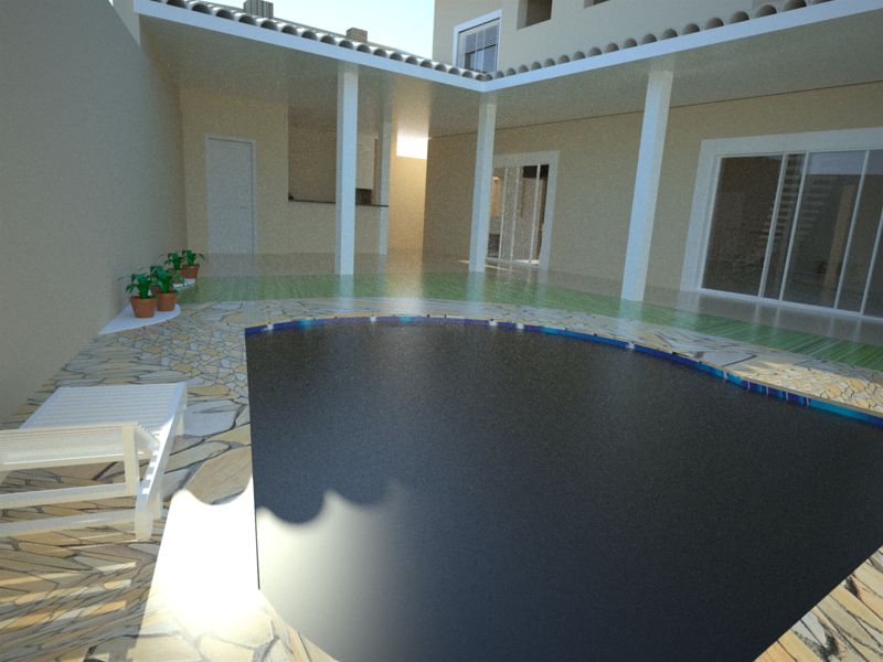

Post by CrisRCM » Sun Feb 01, 2009 8:21 am
Not so good yet...
My water isn't transparent, I can't see the pool's tiles.
Material configuration:
Indigo mat: SPECULAR
Spec type: glossy transparent
Exponent: 100
IOR 1.330
I also tried to reduce the height of the water (volume) but didn't work.

Post by Borgleader » Sun Feb 01, 2009 8:28 am
could we have a wireframe view of your scene pretty plz? (and maybe a screenshot of your mat settings too)
CrisRCM
Posts: 13
Post by CrisRCM » Sun Feb 01, 2009 9:02 am
Sure!
The screen shows the Indigo Material Configuration, Blender Material Configuration and Wireframe.
If you need anything else, please, let me know.
Thank you in advance.
Please, click on image to enlarge.

Post by Psychotron80 » Sun Feb 01, 2009 9:11 am
to my naive understanding, glossy transparent is the problem: water is not glossy I think.
why don't you use the water in the material database?
http://www.indigorenderer.com/joomla/in ... Itemid=107
Post by Borgleader » Sun Feb 01, 2009 9:21 am
well for one, your water mesh should be as deep as the pool itself.
for two, i wouldnt use glossy for the material setting.
CrisRCM
Posts: 13
Post by CrisRCM » Sun Feb 01, 2009 9:39 am
Hi Psuchotron80!
Thank you!
How do I use a .igm file?
What I did was put the material as "specular" and adjust the RGB values of "absorption" and "scattering" (following your URL)
But my water still not transparent. The water looks like a mirror.
Sorry guys, but Indigo is very new to me.

CrisRCM
Posts: 13
Post by CrisRCM » Sun Feb 01, 2009 9:43 am
Borgleader wrote:well for one, your water mesh should be as deep as the pool itself.
My water mesh was deep as the pool. But didn't work too.
I changed the material to "specular" and my water now is a mirror. :)
Post by Borgleader » Sun Feb 01, 2009 9:46 am
The way you use an .igm is to choose "External" mat type and link to the file. you must also make sure the name of the material matches the name specified inside the file or else it wont find it.
So just open the .igm in notepad and check that the name of it is and then use that in blender.
CrisRCM
Posts: 13
Post by CrisRCM » Sun Feb 01, 2009 10:11 am
WOW!!!! That is great!!!! My water now is a really water!
I'm rendering again. I'll post a new render in few minutes.
Thank all!!!! You solved my issue!
Post by Borgleader » Sun Feb 01, 2009 10:17 am
Glad to hear its working :)
