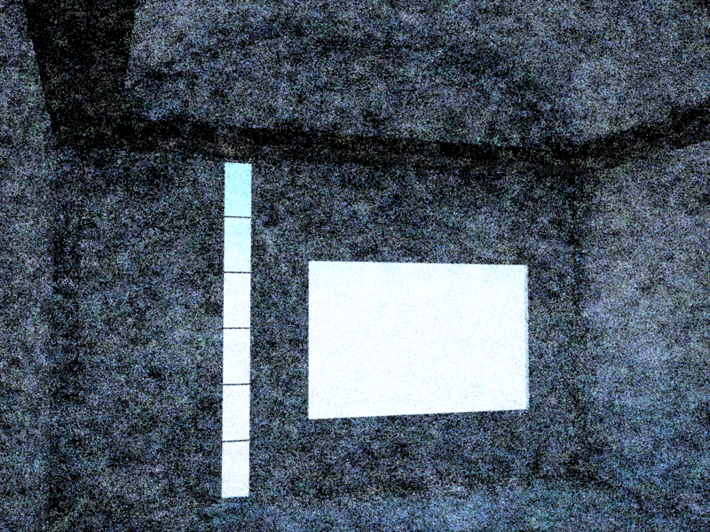

I would like to know why my sun in all my scenes gives blue light. My windows should be letting in bright yellow sunlight ( i think). I am using physical sky+sun
I can post up my .blend file if it would help?
Yeah these images need much more time, but you can see it is blue

I dont know where the sun is in your scene, but the blue light comes from the physical sky.
This system (and sky color) is affected by the position of the sun in blender.
What i always do in internal scenes when i want a yellow glow is to set up meshlights in the windows. Downside is that you would not see the outside world
Post by pixie » Fri Oct 31, 2008 9:49 pm
you have to white balance your image, then it will give you a nice :roll: white

the sun should be coming through the window and shining onto the floor. When i set my veiw on the floor i can see the sun through the window.

Op fixed it, thanks smartden. had to make the sun face at the house.
