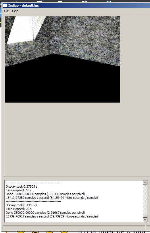

When I delete all the faces from the bottom of your structure, the problem with BiDir goes away.
EDIT:
This must be a bug - take a look at my screenshots.
I removed the bottom portion of the mesh - the remaining floor is a simple plane.
Export without that plane - normal speed render.
Export with plane - SLOW render.
Plane not exported.
Normal sample rate for scenes.
Plane exported.
1/15th the speed for some reason.
