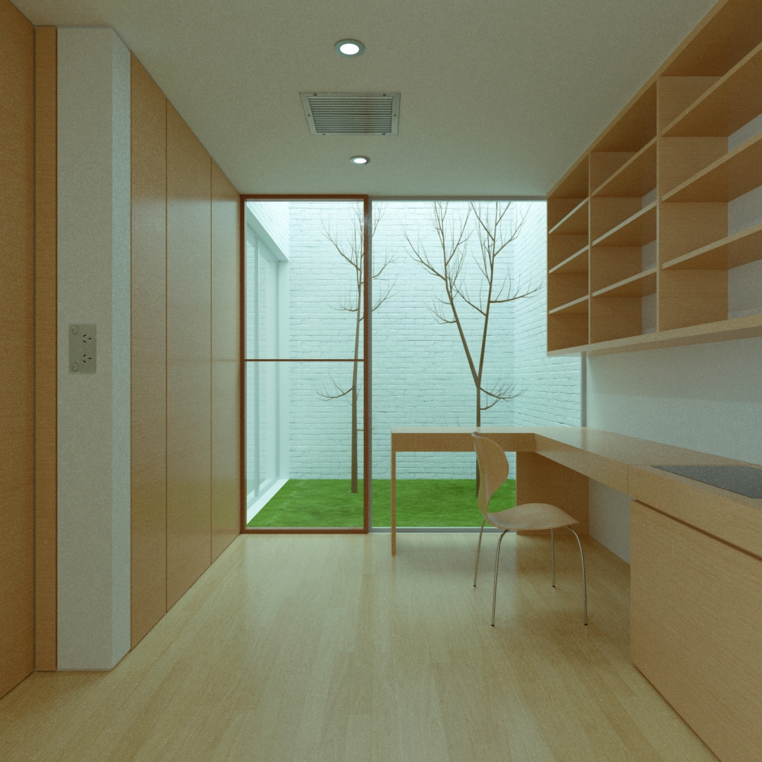

I'm trying to replicate this scene:
http://www.telardigital.com/afecelis/in ... _ref01.jpg
I'm working on the modeling/lighting part and before applying materials I'd like to know if it's possible to have both mesh emitters+ ies lights working together to simulate the circular spots on the floor. I tried using one mesh for the emitter and a second copy of it moved a little underneath it for the ies light but it covers the emitter. I tried then to move the ies mesh away from the emitter, now I can see both the mesh emitter and the spots on the floor, but I can see the mesh of the ies light. Is there a way to make a mesh invisible but still have it emit light/ies light?

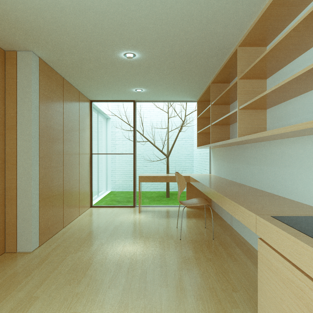

Here's my image so far:
Thanks for any help.

Here's some progress on the texturing part (I also changed the sunsky for large emitters outside):
Thanks a lot for replying Vasco.

OK, here's some more progress:
-I used the reference image in blender's viewport to improve the framing of the scene.
-Checked up all proportions
-Added the AC grate and the outlet.
Pending:
-Adding the bonsai
-Adding the desk lamp
-Getting ies lighting to work.
I'm going to post it in the simple renderings thread
