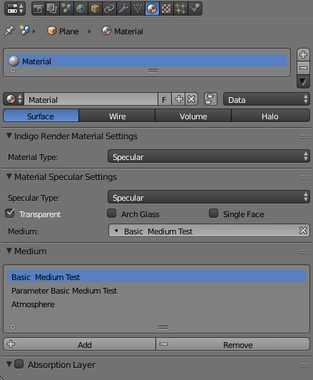

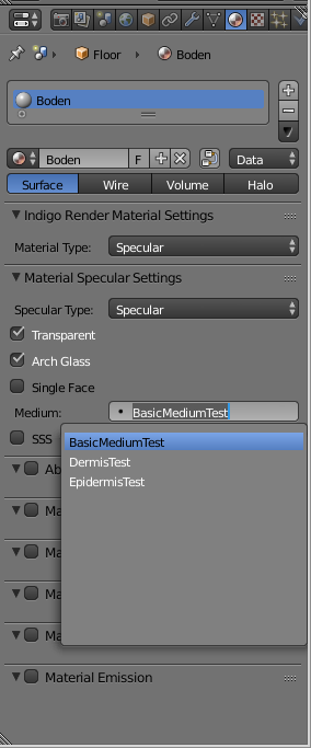

Hi,
i started to de-couple the medium properties panel from the material tab. I moved the medium definition to the world panel and make a selection box in the Material panel.
World Panel:
Material Panel: It is the first draft which works well for me (inclusive the export). I will move the medium definition panel in the future into a template_list which is much more comfortable...
Some questions:
- The indigo demo (full version) always show an error: dermis / epidermis currently not currently supported... I used the demo version because i only have a RT license. Is dermis / epidermis supported in full version? If so i am not able to test it...
- Should SSS options placed into the medium panel or the material-(tab)? As i understood SSS is an option for a medium, not a material...
- Any other suggestions about the UI?

Re: Design question: de-couple material from medium...
Dermis/epidermis is disabled in full version as well.zurkdahool wrote: Some questions:
SSS is definitely medium properties. Where to display it best is a UI issue however.
FakeShamus
- Posts: 512
- Joined: Wed May 02, 2007 11:34 am
I think placing the medium definition in the world tab is kind of confusing. keeping it associated with the material tab but somehow allowing for various materials to re-use a medium once defined would be better. but the capabilities of python are beyond my full understanding, so I don't know what's doable there.
- zurkdahool
- Posts: 34
- Joined: Thu Aug 27, 2015 12:14 am
- Location: Germany, Berlin
It should be possible to place it into material tab but to change a medium (which can be assigned to many materials (1:n) ) may become also confusing? Hmmm, have to think about it... *confusing*
I will check if it's possible to code it into material tab...
- zurkdahool
- Posts: 34
Agree! I think that makes more sense: Nice and easy, huh?!FakeShamus wrote:I think placing the medium definition in the world tab is kind of confusing. keeping it associated with the material tab but somehow allowing for various materials to re-use a medium once defined would be better. but the capabilities of python are beyond my full understanding, so I don't know what's doable there.
The medium parameters and SSS options will be placed under the 'Medium add / remove' widget (above Absorption Layer). It is currently work in progress and not on the screenshot...
To place the medium widget into material tab is more work and a little bit tricky (storing global properties and so on ...). Hopefully it will work...

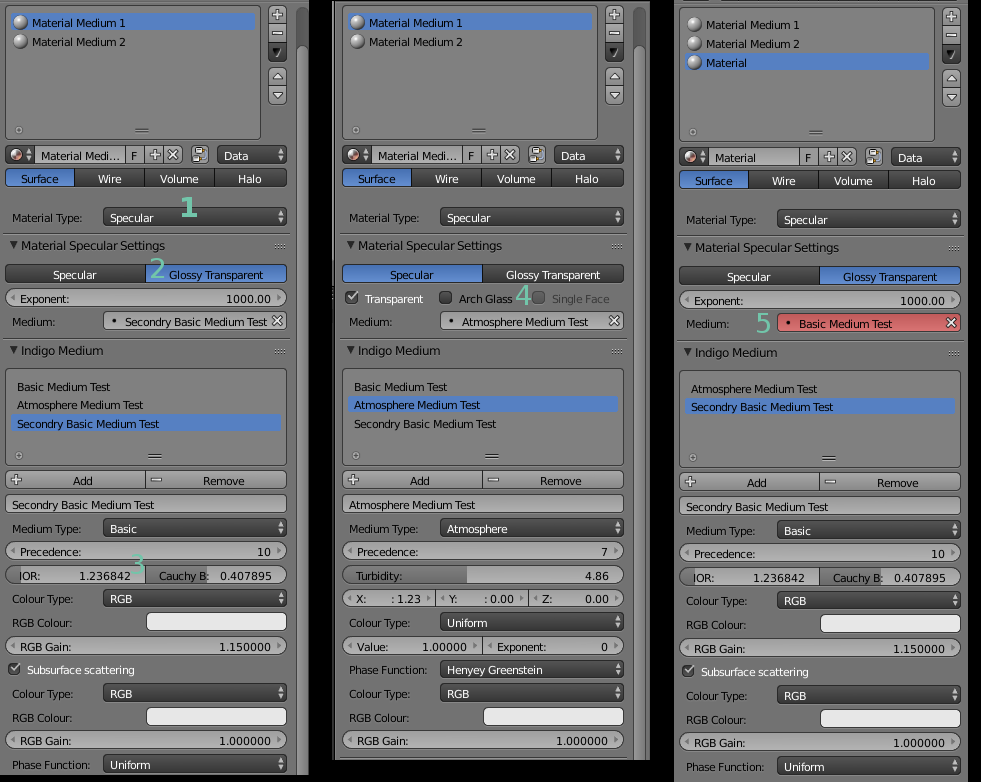

Done... export is working. Medium is now total decoupled (also most of the code)...
Before making a pull request to official blendigo tree in the next days i will fix some minor issues and do some testing (help are welcome!)
I have done some additional UI work:
(1) Material Type now directly in MaterialButtonPanel (not in extra widget)
(2) Enum Button instead of Menu (fast and easy access - i like to 'push that button'
(3) Slider for some values
(4) Dependencies will greyed out (beta)
(5) Alerting ...
Hope you like it.
(5) Alerting ...
Hope you like it.
