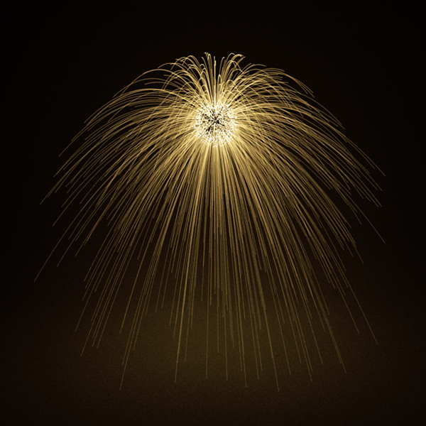

aleksandera
Posts: 380
Location: Slovenia
Re: Blendigo 3.8.5.2
Post by aleksandera » Thu Jul 17, 2014 4:25 am
My try.
I guess It works just with one particle system for now?

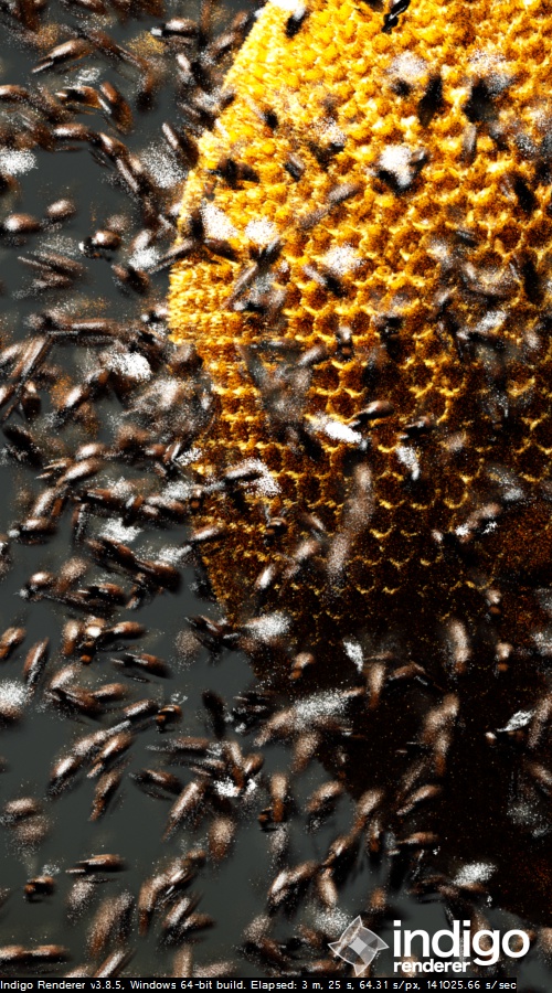

Post by fbrunell » Thu Jul 17, 2014 2:37 pm
Right now I am about 6 inch above ground floating around in my basement. I am close to heaven.... I can barely contain my emotions.....
1. Camera motion blur seems to be finally fixed
2. Particules motion blur is working like a charm (with one particle system)
P.S. I noticed that motion blur slows down rendering considerably. Is this normal behavior? I have a scene with about 450 particules. Without motion blur, I get about 2400k sample/s. With motion blur I get 240k sample/s which is about 10%. (I guess that his has nothing to do with Blendigo but more with Indigo right)...
EDIT : Indeed, particle motion blur seems to be working only when one particle system is present. With two, I got the following error message :
A problem occurred with the scene:
Error while building scene: ObjectExcep: Frame times must be strictly increasing. (model UID: 15)
Indigo version: Indigo Renderer v3.6.18, Windows 64-bit build.
Exporter: Blendigo 3.8.5.2
Platform: 8 6.2.9200 Multiprocessor Free - Windows FBWKN013 8 6.2.9200 AMD64 Intel64 Family 6 Model 44 Stepping 2, GenuineIntel - Python 3.4.0 (default, Apr 19 2014, 02:21:04) [MSC v.1800 64 bit (AMD64)]
Author: frederic.brunelle
Description:
Date created: 2014-07-17 02:46:18 GMT
Please contact support@indigorenderer.com if you have any questions.
