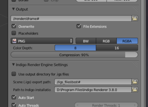

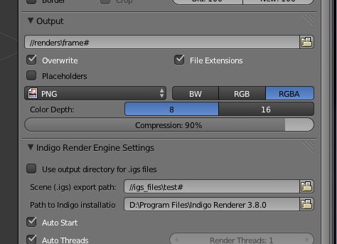

From the next version on, the path in the "Output" section will be primarily used for the image file output (with the # characters working as intended).
I also introduced a "Use output directory for .igs files" checkbox (enabled by default) and a "Scene (.igs) export path" (used when the checkbox is disabled) that lets you specify the directory/name for exported .igs files (also allowing the usage of # characters for frame numbers like the blender output path).

fused wrote:I ran into this as well when I was looking into various blender related issues and found it a little unintuitive.
That's a great idea, flexibility when needed. I think the more options there are, the better, and they can be hidden under 'Advanced' tabs to reduce clutter, if needed.
